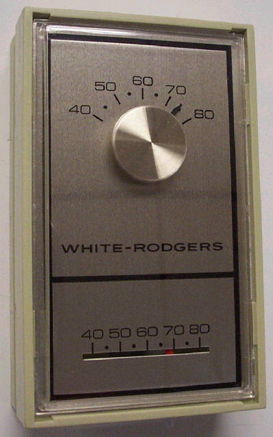

am i right in thinking i can change between hot water and central heating on my new heating system by using a three port valve and have heat up or downstairs by using zone valves ,all without wall thermostats which are ugly,thanks. :confused: :confused: :confused:
NO, you have to use room stats (the large ugly ones are vey good)
you could try this
its a building regulation thing about room stats, and besides how will the valves know when to close down without them?
