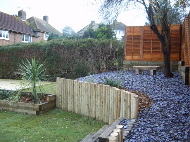

most decent fencing suppliers should do them. They are a pain in the arse to do!
you need to dig a trench and then set them into the trench and put a semi dry mix in around them.They are a bugger to hold in place and line up. You can use metal banding on the back and screw them together, or timberlock them through. Personally i dont like doing them and i much prefer a decent sleeper wall. much sturdier, cheaper, quicker and more robust.
heres one we did a few years ago
Thanks Thermo, problem I have is that our garden is on the second level, so I thought these would be easier to move! How are sleepers cheaper? The width is around 10 meters and 900mm high. I was going to use sleeper for the steps though :)
