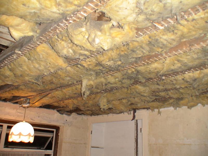

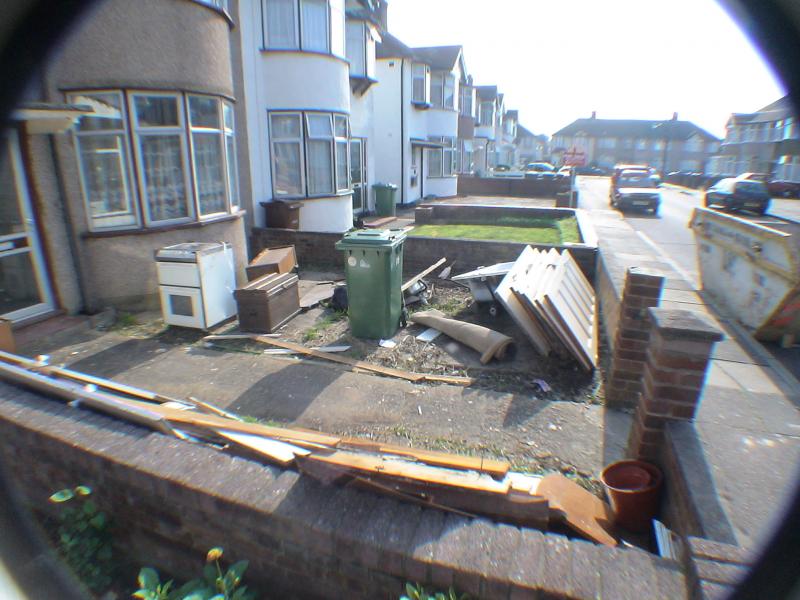

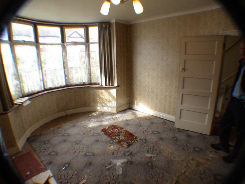

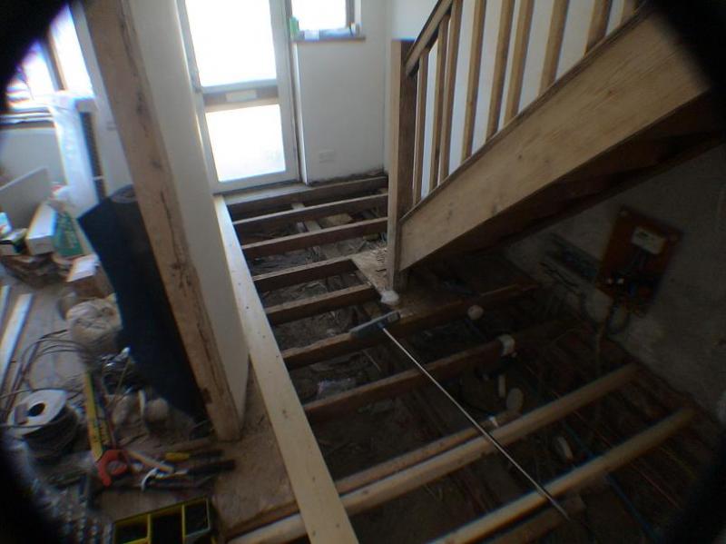

Early Stages... View media item 2220
Almost the same as my house, which i just bought and in process of ripping apart at the mo, its great taking the ceilings down haha

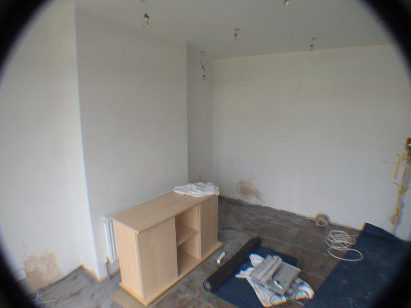

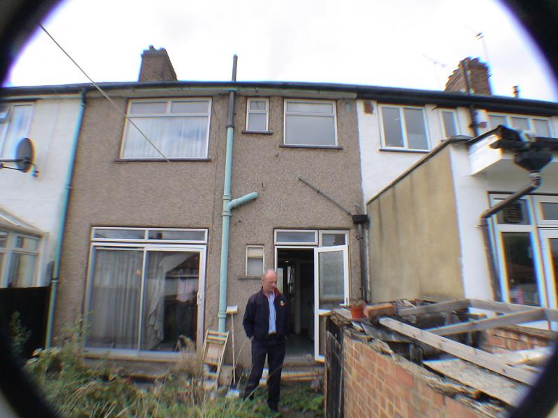

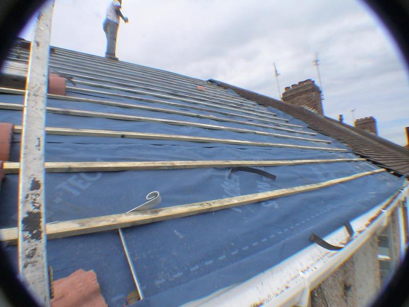

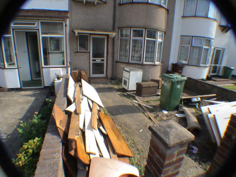

Few more Pictures...

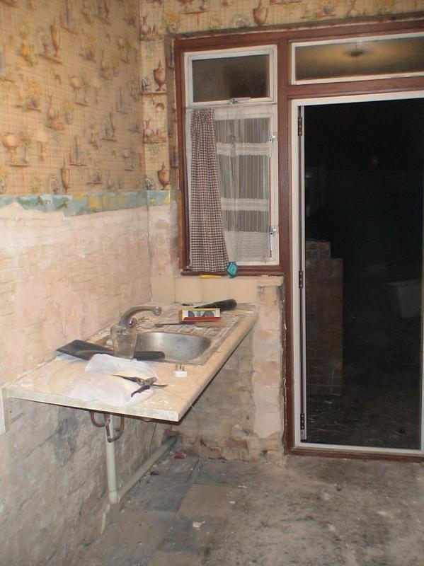

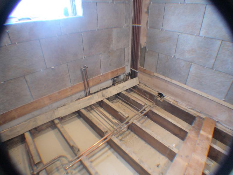

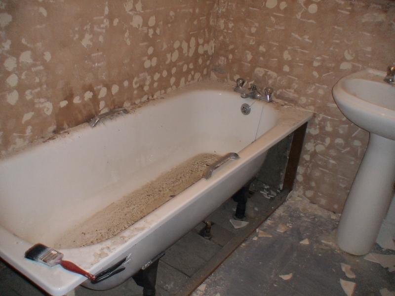

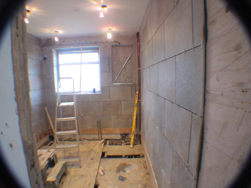

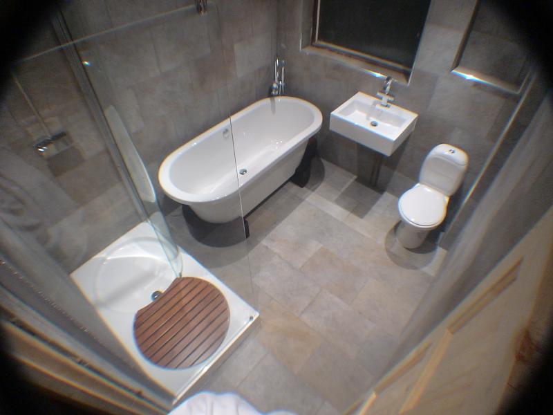

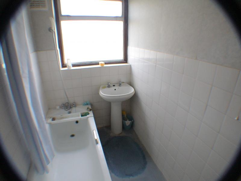

These are the befoe and after pictures of the bathroom, put underfloor heating in the bathroom...
Bath and Sink are left in the same position, I have knocked down thw wall and also left the toilet in the same place...
Only thing i have added was the shower...
There are 2 speakers hidden on either side of the bath and are connected up to the main hifi unit in the house, just in case I need to nip to the loo during a football game, also is much better then listening to a tinny little radio

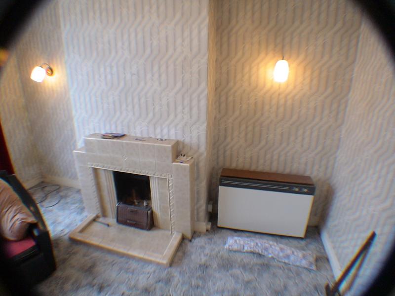

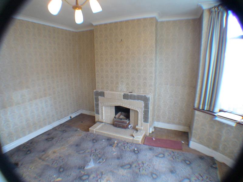

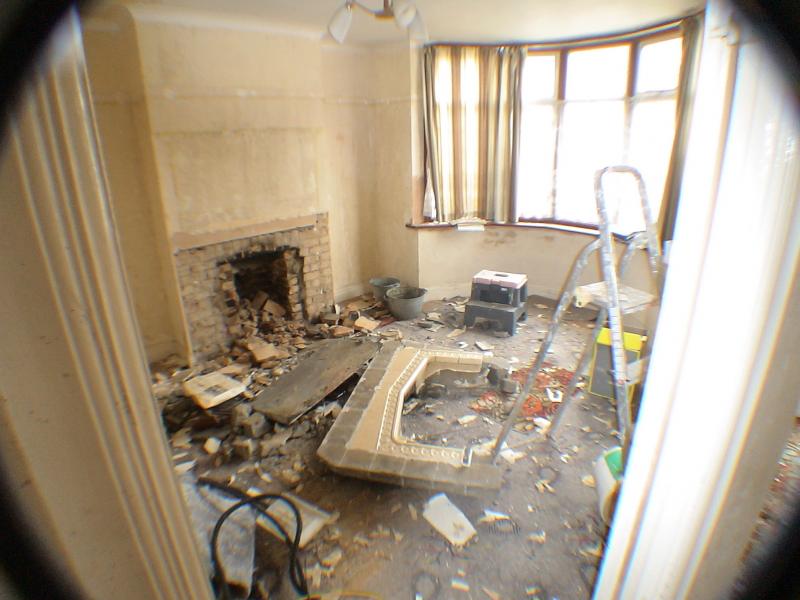

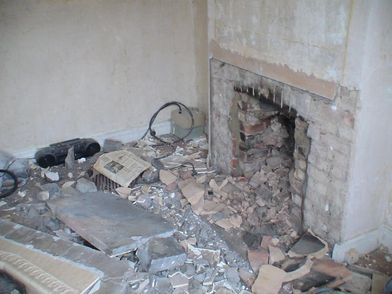

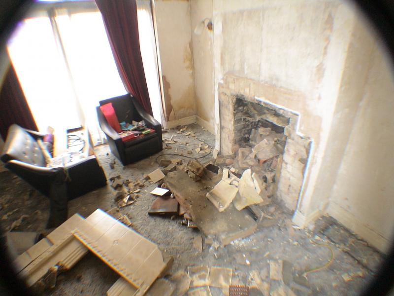

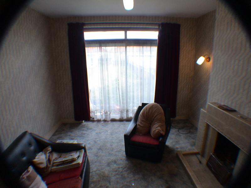

Befor and after of the fireplace...
Blocked up the fireplace tho...

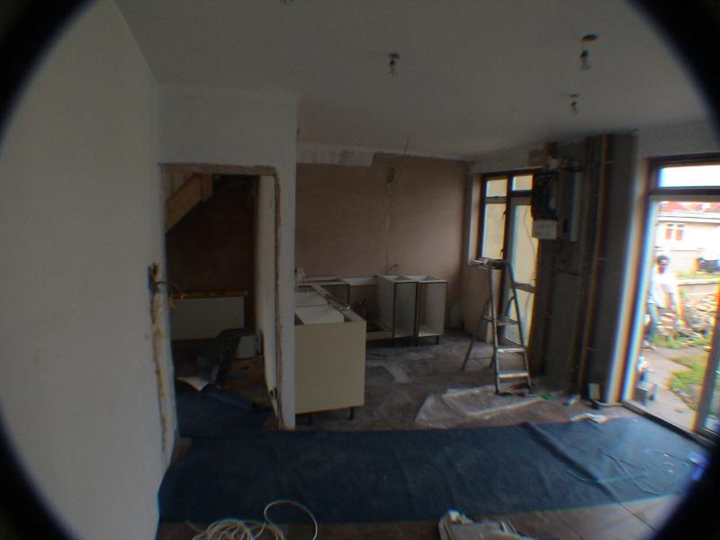

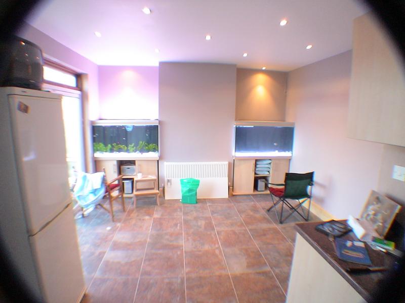

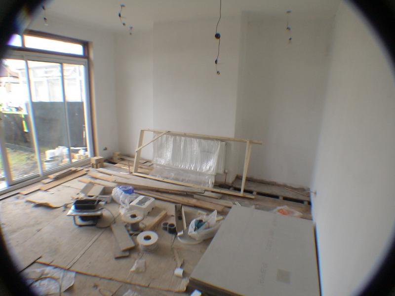

I knocked down the wall seperating the kitchen and backroom...
The radiator infront of the chimney, did you put an airbrick in behind it? If you block the chimney at the top you'll also need an airbrick higher up too.
If you don't put airbricks in, chances are your chimney will get damp.
I have put a fire place in the front room so have not blocked the chimney up...
I didnt put a air brick in the back room, come to think of it I think I should have, Hopefully there will be enough air circulation from the fireplace in the front room...
I think the bathroom looks awesome.
Iv got to do a bathroom from scratch to and id like to do some like what you've done.
If you don't mind me asking, how much were those tiles and where did you get them from?
Thanks Rob...
I got the tiles from a place called Decor Tiles based in Watford, www.decortiles.co.uk
To be honest I cant remember how much I paid for them Per Square Meter but in total I think they came to about £700...
