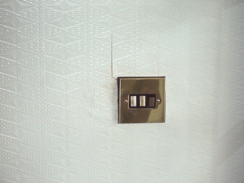

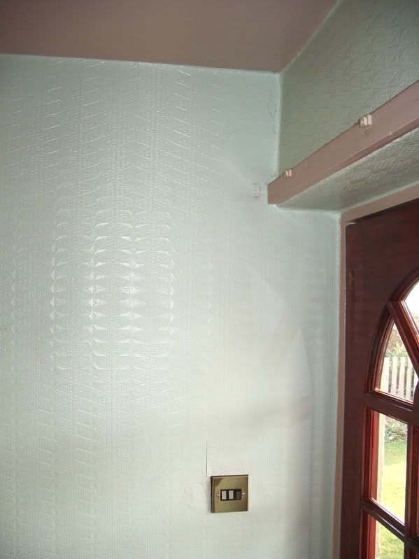

Fed up of spending money on all those expensive RCBOs?
Just follow my simple step by step guide.

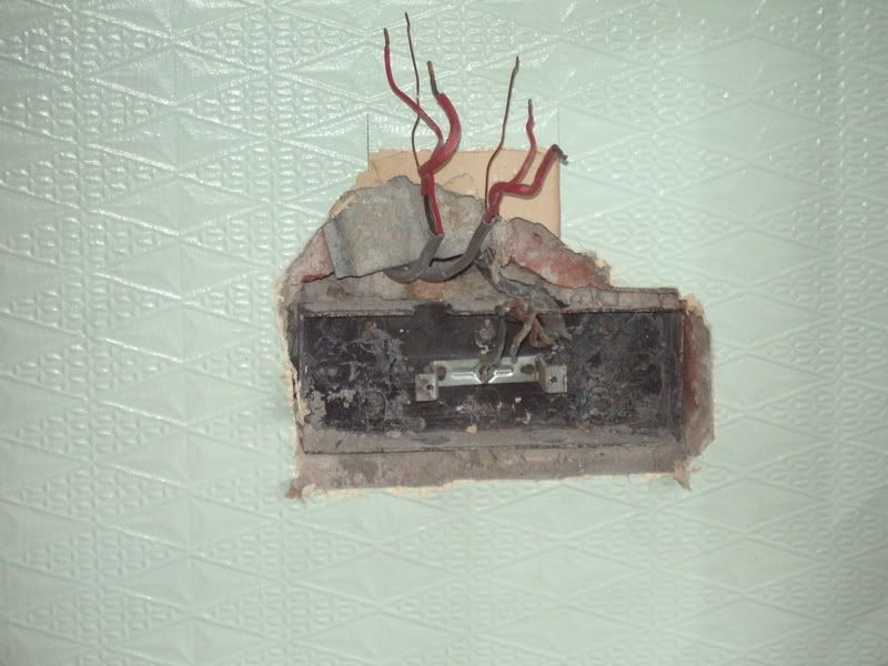

Existing switch:
Mmmm brass:
Nice bit of crunchy rubber:

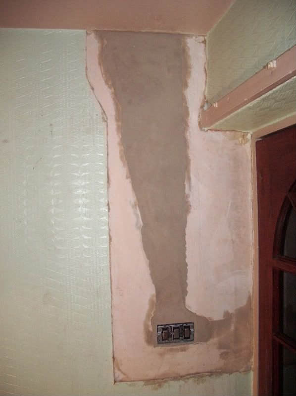

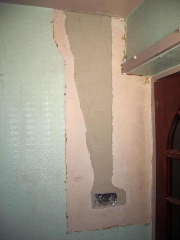

Original 3 gang box for dolly switches. It was just bunged up wih plaster.
Safe zones. What are they?

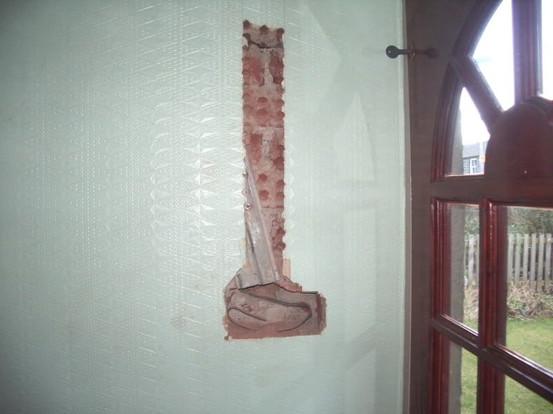

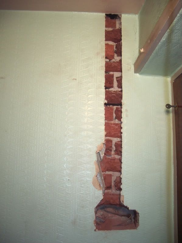

Chased out:
Box and steel conduit in place:

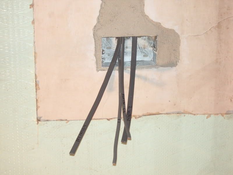

Roughed in:
Wired:

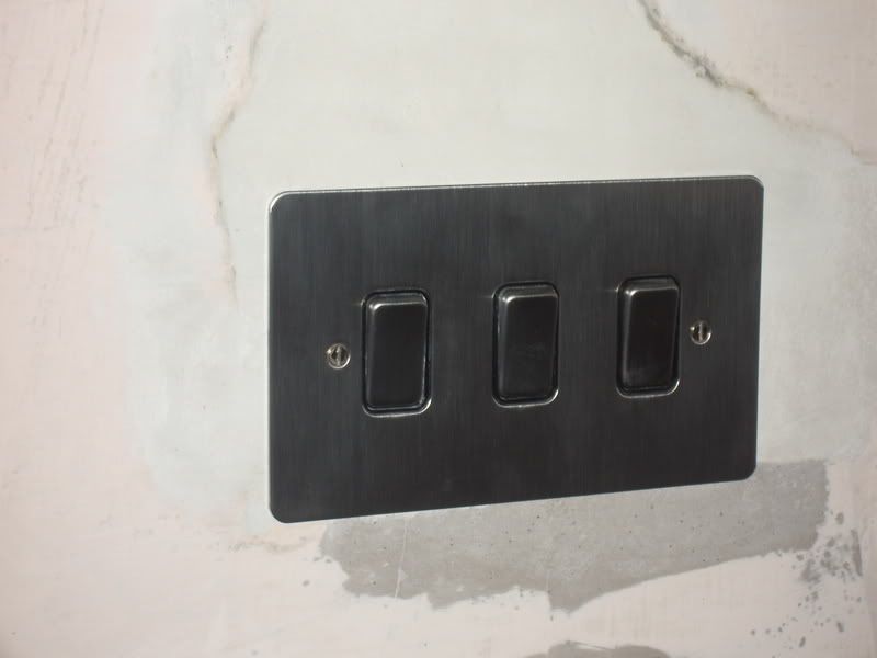

Finish plastered and switch connected:
Plate on:
Done:

What did you do at the tops of the conduit?
Female bushes :)
No, that's just the camera angle. I certainly didn't cut one length slightly shorter than the other :oops:

I'm used to working with steel, so to me it is just as quick as capping or oval conduit.
If you are not then there would be additional time for threading etc, and the expense of buying stocks and dies etc.
The chase was maybe 10mm deeper than normal, but this doesn't add much time really.
You are looking at maybe 15 mins extra per switch, but you are also left with the bonus of rewireable switch points.
You might end up breaking even on price when doing a whole house, but for just replacing or upgrading one switch drop then this to me is the way forward.
