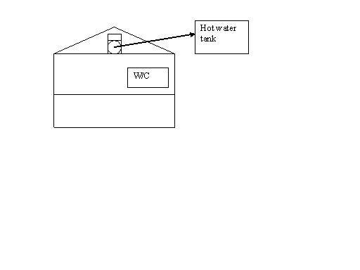

Following on from a a previous post I have decided to move my gravity fed system to the loft that will allow a couple of meters height on the old setup
The new setup will not have any where near the extra height from the cold water tank to the hot water tank.
The question I have is does the pressure increase come from the height of the Hot water cylinder (I assume it does) and also how much higher does the cold water tank need to be above the hot water tank (it will not be much).
Final question is I want to add a shower, will it just run from the same hot water tank if I install a separate cold water tank for it?
Hope this makes sense!

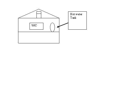

I think I have two option if I am to stick with the gravity (seems like a good idea)
One is to put both hot and cold tanks in the loft high up out the way, the main issue is there will be poor pressure due to the close proximity.
The other option is to have the cold water tank high in the loft and have the HW tank in the bathroom airing cupboard with a slightly dog legged pipe run 35 degrees or something. This will give me some pressure but the pipe work will not be vertical?!
Can someone advise please. Any help greatly appreciated.

It is solely the height of the cold water tank above the taps that determines the pressure. It matters very little how close the hot water cylinder is to the cold water tank, although additional restrictions of water flow thought pipes will have an effect.
When you tunr on a hot water tap, it gets its water from the cold water tank, via the hot water cylinder.
if you had both tank and cylinder in the loft or tank in loft & cylinder downstairs your pressure at the tap will be the same.your head pressure (hight of water level above outlet) will still be exactly the same.fill a 2m length oh hose pipe with water, if both open ends are the same level no water will come out, even though the dip in the hose (your cylinder) is on the floor. i hope this helps you understand a bit more :)
Cheers Dextrous
So stick with plan A and put them both in the loft close to each other.
This will give me a vertical pipe run and be much easier to do so good news.
I am building the plat form to accommodate a 50 gallon tank so I can run a shower from it if need be.
Sound like a plan..... I'll get building then
Both have advantages and disadvantages, but for a better flow rate the first is the better option as it involves less pipework from the cylinder to the bathroom taps (but more from the boiler). Plus it will be easier to install a pump should this prove necessary.
Not entirely sure I understand the OPs intention.
I would move the cold storage cistern into loft, but leave cylinder where it is
