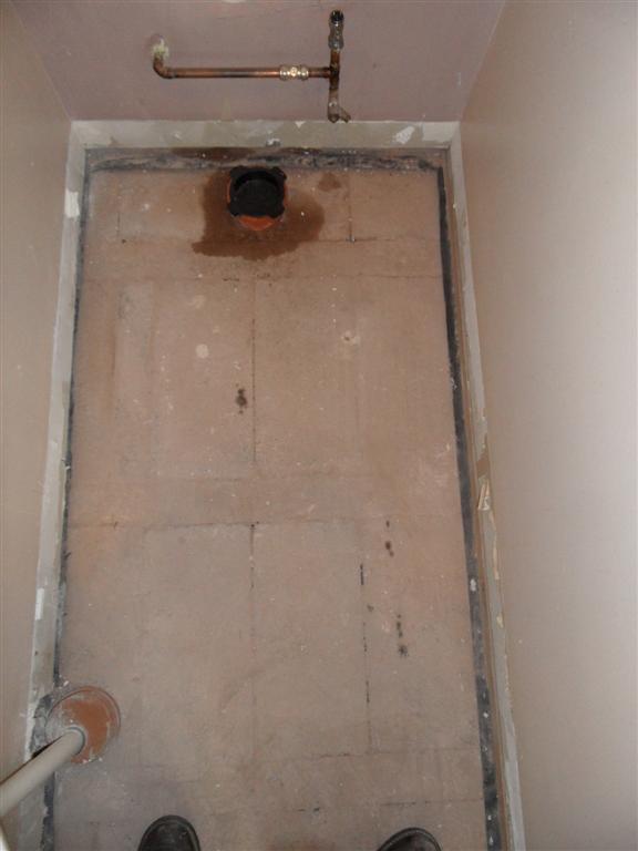

I intend laying ceramic tiles on the downstairs toilet floor but on lifting the vinyl floor tiles, I have found that the 18mm chipboard floor underneath, is floating on a layer of 20mm polystyrene and blue polythene membrane. Underneath this the floor is concrete. The house is a bryant built property from 1996.
Now would the concrete floor that's there already, have an integral dpc below it or is the blue membrane the only dpc used? Could I use a deep base levelling compound directly onto the existing concrete floor to make up the 38mm that I need to raise the floor before tiling or do I have to put some screed down on top of the existing blue membrane before putting down the self levelling compound?
