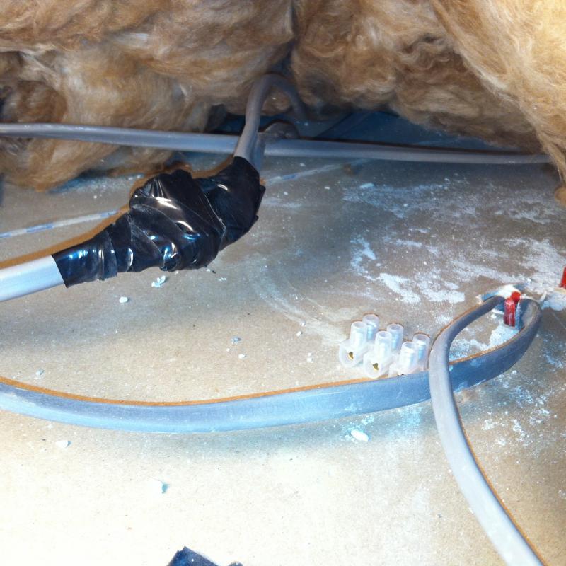

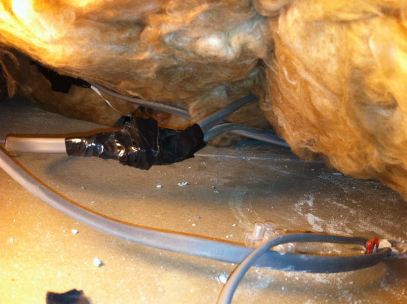

As promised, I took a couple of camera phone pics.
We have two loft spaces. These are from the smaller loft above master bedroom, ensuite and office.
I didn't need to climb into the loft to take these pics... just stuck my head through the hatch and lifted the insulation.
As you can see the single cable splits into two via the connection block, which then feeds two 13A double sockets.
The fat, flat cable at the back of the pic is for the power shower, the cables in the foreground for a ceiling light.

Thanks. At least as bad as we had feared!
Things may well be getting worse (as I feared might be the case). Do you know the 'rating' of the breaker in your Consumer Unit that controls those two sockets (it's probably labelled 'B32' or 'B20')?

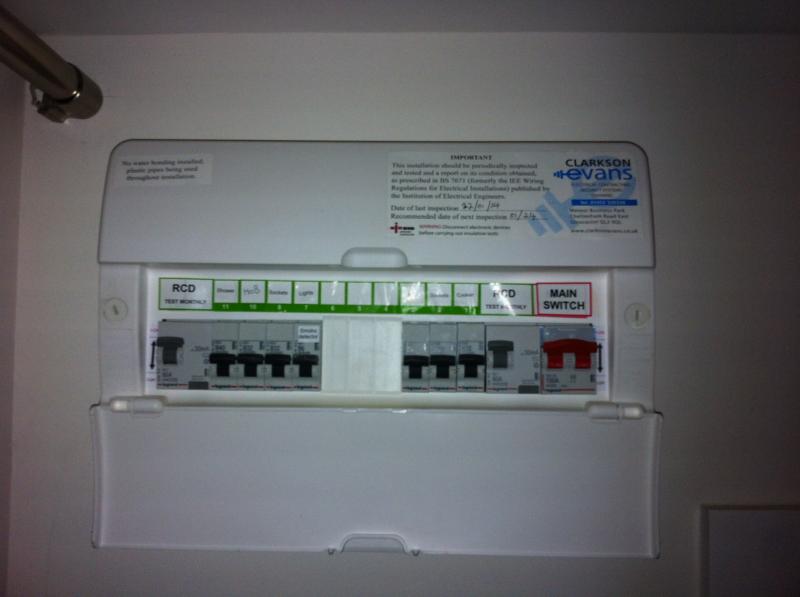

One BS32 breaker for all the sockets in the house (see pics).
Right. If, as is very probable, those sockets are all supplied from a 'ring' circuit with 2.5mm² cable, then that arrangement of a 'Y-split' of a cable to supply to double sockets would be non-compliant with regulations, unless there was a 13A fused 'spur unit' somewhere in the single cable feeding that Y-junction. Do I take it that there is not a 'fused connection unit' anywhere that could be associated with those two sockets? Getting someone competent to look at how those two sockets are getting their power is probably another thing to go on your list!
