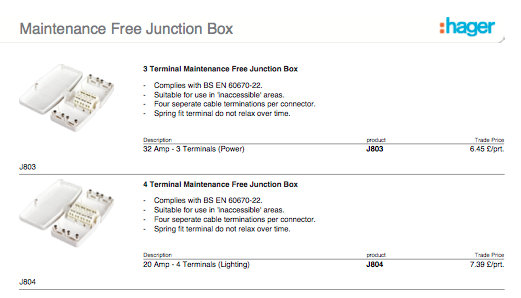

They're only rated at 32A (20A with four conductors)...
That's true - but have you (or anyone else) got any thoughts about the reason for the difference? The terminal block assemblies appear to be identical in the J803 and J804, the only difference being that the latter has one more 'terminal block'.
Kind Regards, John
I presume the extra terminal block, which would be for additional line conductors, would lead to extra heating.
They do specify them as: 32A - power and 20A lighting ???
Were I using it for additional CPCs I would still consider it 32A.
Unless there spring terminals are far worse than I had imagined (and I'm sure they won't be), there should be no significant heating of any of them - so I frankly doubt that's the reason.
I don't recall having seen them do so in so many words. However, the fourth terminal block position (not used in the J803) is labelled 'loop' - which (as expected) presumably means that they intend it to be used in lighting circuits.

I just assume three blocks and conductors with 32A will get warmer than two.
However, the more I think about it the dafter the limit seems.
Page 17.

They have 32a or 20a embossed on the cover.
EDIT, just realised you meant the words power and lighting
They also stamp on them not to cover them, so I take it they are concerned with overheating.
Et voila, from the Hager catalogue
Yes, but as I said, if any terminals in any JB (even if in a 'high-current' JB) get significantly warm, I would think that there is something very wrong with the terminals or design.
IHowever, the more I think about it the dafter the limit seems.
Quite.
Kind Regards, John
Fair enough, but it's just plain silly to draw any conclusions from that. What matters is the current. 20A is 20A, and 32A is 32A, whether in the context of a 'power' circuit (whatever that may be), a lighting circuit, or any other type of circuit (if any other types exist).
Kind Regards, John
Maybe - but, as I've said, if they are concerned about that, I would say that they really need to re-consider how satisfactory (indeed, safe) their terminal assemblies actually are!
