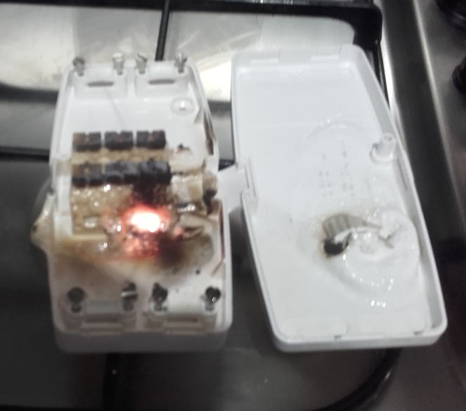

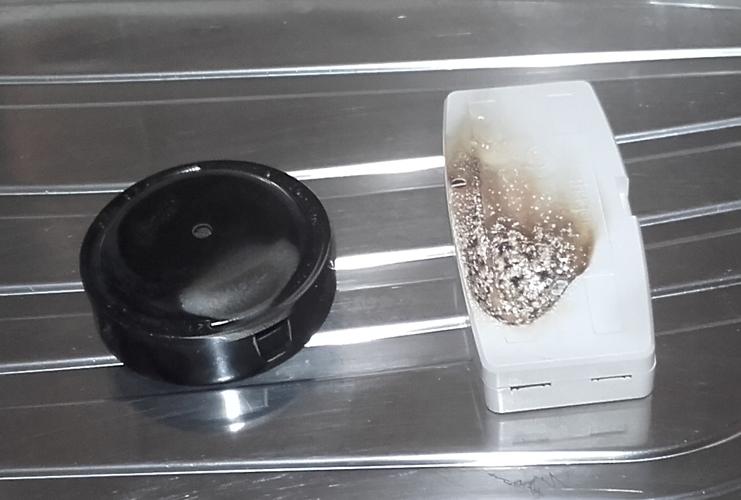

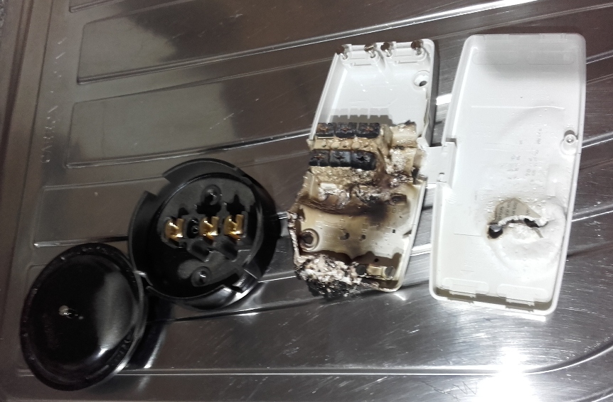

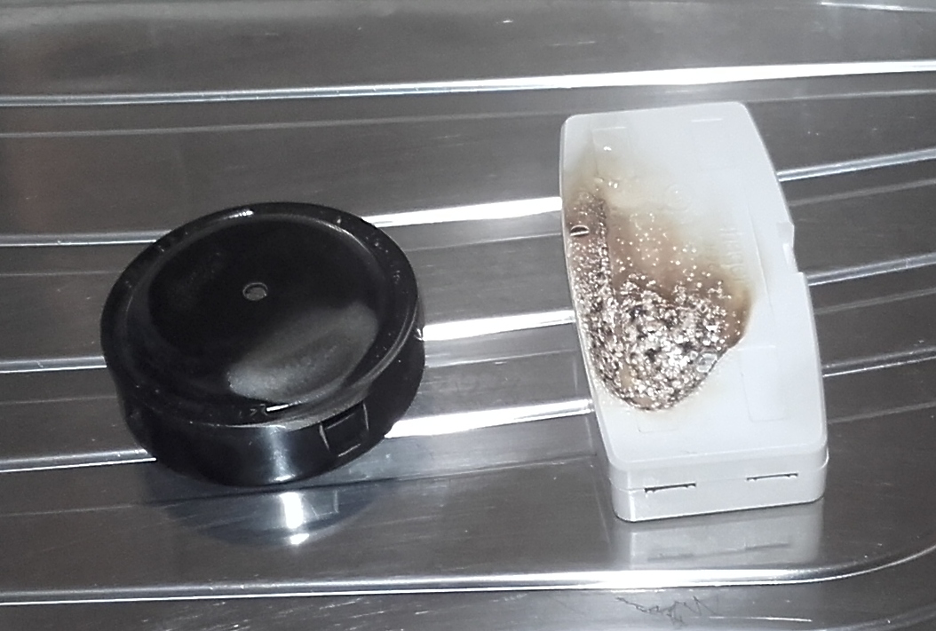

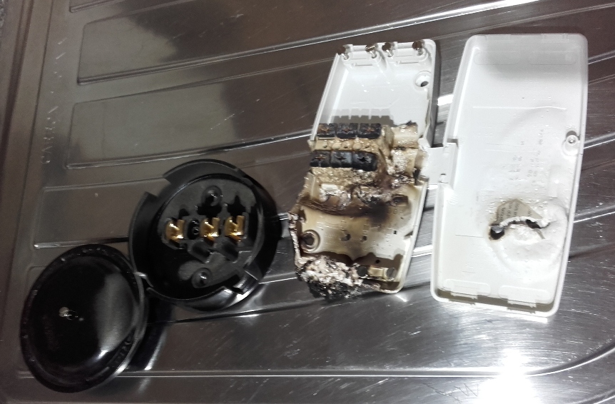

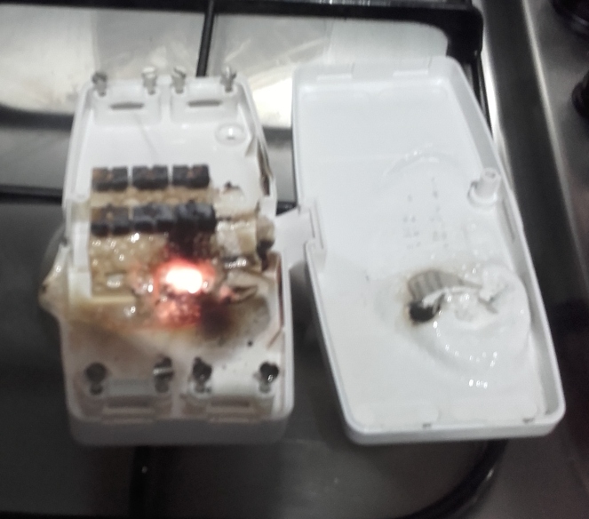

It's probably good to try to stop the MF JBs overheating, they don't seem to like heat. The MF JB was heated gently with a small flame from a gas torch, the round one was blasted for a substantial time with the flame at full power. The MF one although fairly heat resistant ignited, but self extinguished after giving off lots of stinking black smoke, the round one I could not ignite and it only scorched.
Sorry for the blurry pics!

It's probably good to try to stop the MF JBs overheating, they don't seem to like heat. ...
That I would not dispute. However, as I keep saying, if there were a risk of "overheating" (particularly to the extent of damaging the enclosure) as a result of current through the sprung terminals, then I would be very worried about the adequacy of those terminals.
Indeed, all we are debating (in response to my question) is adding a terminal block accommodating four further conductors to a JB which already was accommodating 2 x 4 live conductors (L and N) in terminal blocks identical to the 'additional' one - and I personally find it hard to believe that such would necessitate reducing the rating from 32A to 20A.
Do you really expect terminals joining cables carrying 32A to get even remotely hot (even 'warm') ??

There must be some reason why it says in big letters not to cover with thermal insulation.
