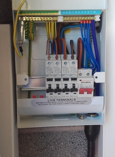

It is reliable and has had no recalls, loads of room in the enclosure, the AM3 boards are much better than the plastic ones. We used to use MK but ditched them after all the faults and recalls. Besides I don't get to choose!
