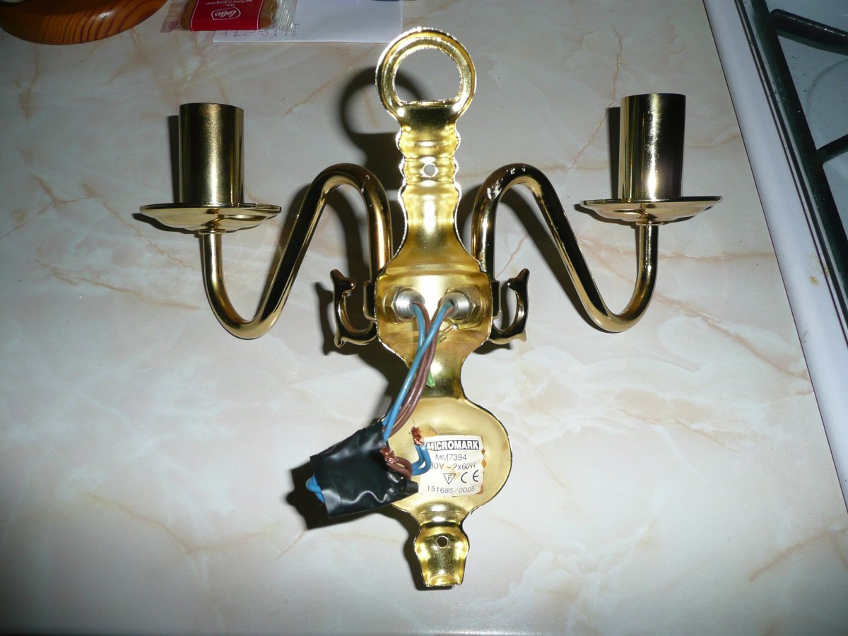

Thanks for reply. I believe that the circuit is RCD protected. I have a fuse box but alongside it is a separate black box with an on/off switch and a yellow button, fitted in 1980. The wall lights are powered by a separate plug which fits into a wall socket and an on/off switch so although metal you never have to touch the lights themselves. This is why I ask again, taking the above into account, is it possible to join some new wire to the existing two wires in some way?

That might be a voltage-operated ELCB, which doesn't meet today's requirements. Can you post a photo of it? Are your light class II, i.e. are they marked with a square inside a square? If not then they must be earthed.

sorry having techi problems now but will upload lights photo again!

That's not a double-insulated light - it must be earthed.
  1. Change the lights
    or
  2. Rewire
    or
  3. Err... that's it.
