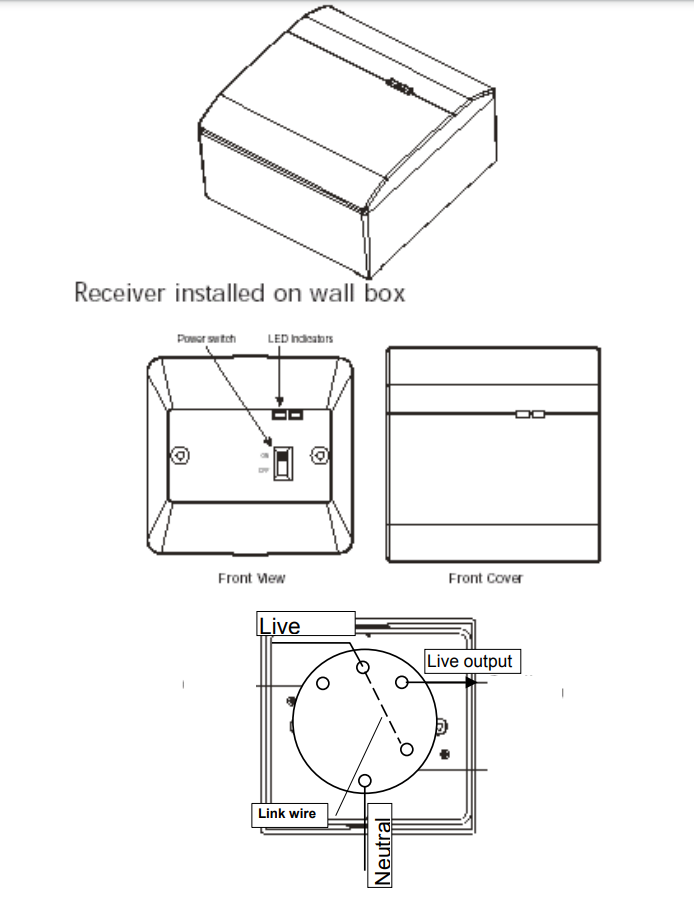

For anyone that can help, this is the receiver I have.

I've seen this, but was hoping to not have to pull the receiver off the wall to pull out a jumper if that isn't what's wrong with it.

I'll take the front off the receiver to check the DIPs, and switch one and remove a corresponding one in the thermostat and see if that works.

I think pulling the receiver apart is the next step.
