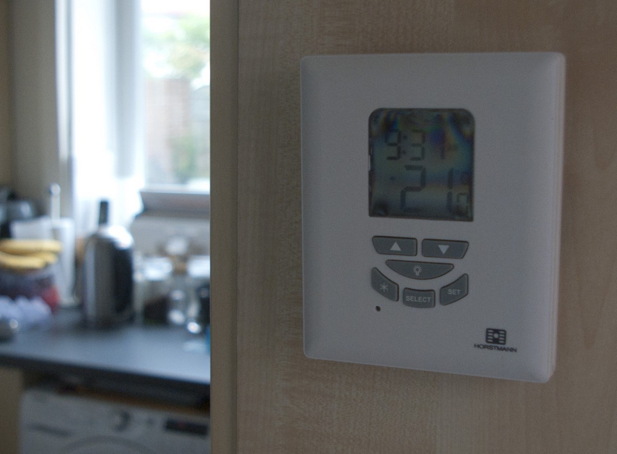

Towerstat RF Issues
Can only be a communication error,or a faulty unit, your settings are all correct, when you took the batteries out to replace them , did the reciver stay on ?
Yes it did.
So if it's communication, I can try changing the 'frequency' using the jumpers, but if that doesn't work, is it more likely it's the transmitter or the receiver or is that impossible to say?
you can try altering the address code, but both have to be eactly the same, if the receiver stayed on with the batteries out of the thermostat I would say the receiver is faulty

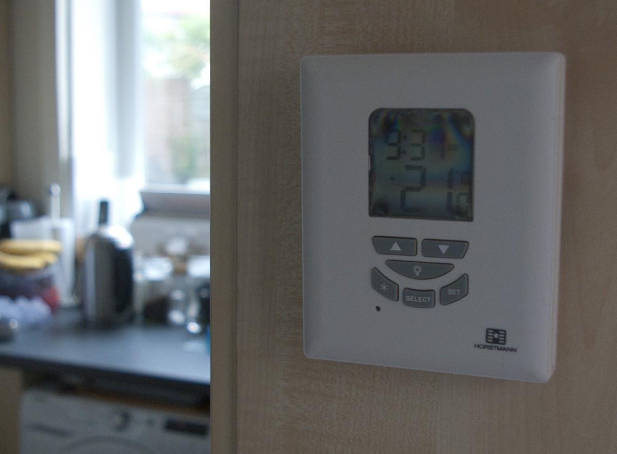

The dip switches change the code not the frequency, mine was well away from boiler so not interference from boiler, I am a radio ham and have a transceiver that works on same frequency, so hunted for some other unit using the same frequency with no avail, in the end the transmitter and receiver faced each other three foot apart, I returned to using the old non programmable Honeywell thermostat instead, mine had the Name "Horstmann HRFS1" cost around £76 at time, now being sold at £30, it did not re-transmit the info, so if it did not register the change then had to set high and low again. It seems it was sold with many badges. They are simply low quality end of.

I had intended to fit Nest, but never got around to it, just moved the Horstmann thermostat onto oven carcase facing the receiver IMGP8037.jpg and it was still working that way when we sold the house, the other house was hard wired with one of these, ae235.jpg that worked far better, and this house has Nest Gen 3 so again hard wired. I tried all the code options and no improvement. But the big problem was no fail safe, if the receiver failed to get the command be it off or on, then it seemed the signal was never resent, so would need to turn up/down or down/up to get the receiver to switch. When I saw with Nest Gen 3 I can manually start it pressing centre of the heat link I thought why don't they all do that? So handy for boiler man, he can test boiler without going to thermostat.

I had intended to fit Nest, but never got around to it, just moved the Horstmann thermostat onto oven carcase facing the receiver View attachment 217601 and it was still working that way when we sold the house, the other house was hard wired with one of these, View attachment 217603 that worked far better, and this house has Nest Gen 3 so again hard wired. I tried all the code options and no improvement. But the big problem was no fail safe, if the receiver failed to get the command be it off or on, then it seemed the signal was never resent, so would need to turn up/down or down/up to get the receiver to switch. When I saw with Nest Gen 3 I can manually start it pressing centre of the heat link I thought why don't they all do that? So handy for boiler man, he can test boiler without going to thermostat.
So I've changed the address code and I still have the same issue.
Is sounds different to what you had though, because it the transmitter seems to send the 'turn on' command IMMEDIATELY, and I mean it's almost instant, just not the 'turn off' command.

Sadly it didn't work. I turned off the 5th DIP and took out the 5th jumper, and once again it turned on the system perfectly. Now the bloody green light is shining down at me again.
