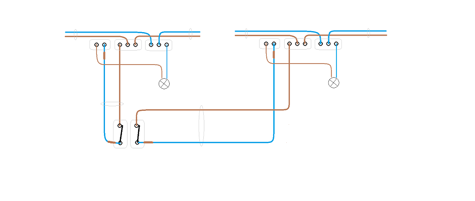

I have this 1 way 2 gang here. Each switch controls a separate light.
Originally wanted to put a smart switch but not too happy with not having a neutral (I have no neutral right?).
Would I be able to put a Sonoff Mini in the ceiling rose to feed off the neutral?
Is there any way to have a Sonoff Mini in the rose control both lights (my guess is no because at best the Sonoff can bypass the switch to feed to light but not the second light)? If so would you recommend two Mini's in the roses or going with a no neutral 2 gang switch?
Bonus question. In a second room I have this, the blue is likely neutral right?
First picture -
No neutral but IF both lights are on the same circuit, the wires could be reconfigured to make one of them a neutral.
Can we have picture of the wiring at the other ceiling rose?

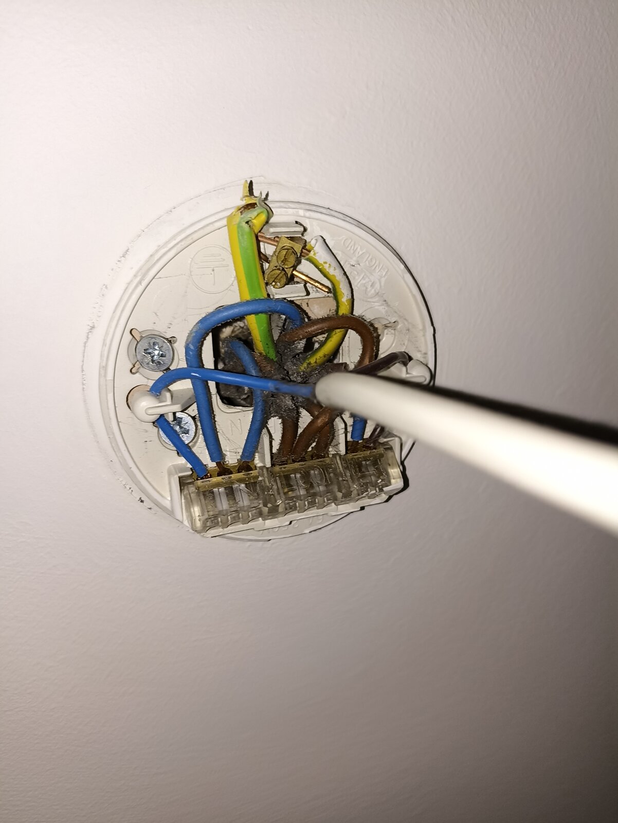

Second picture -
Looks like neutrals in the connector block - are there three? Picture is not very good.
Yeah there are three. I'll get a better picture tomorrow.
Other rose, just checked it looked absolutely awful...

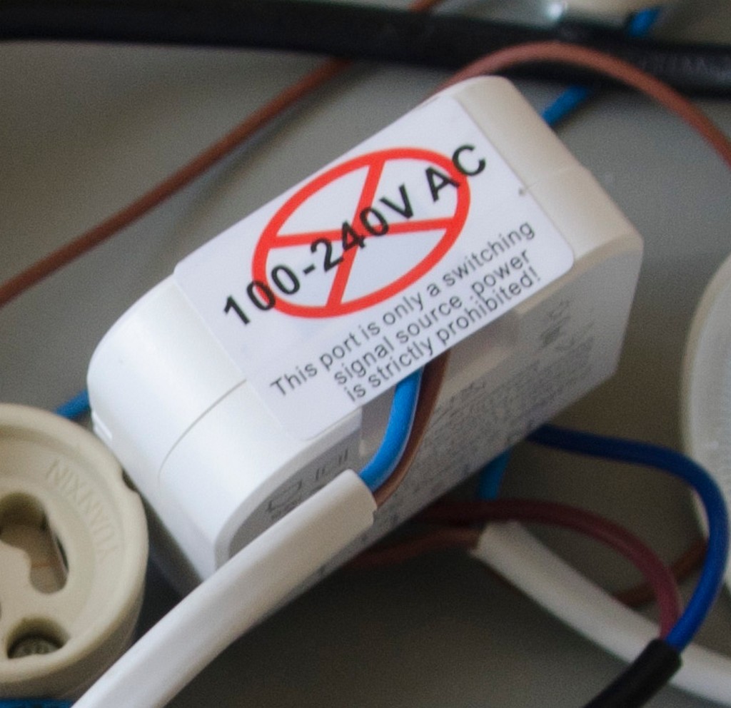

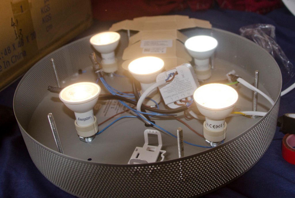

The relay needs room to mount it DSC_6056.jpg seen here being tested, and this was finished result Centre_bulb_colours.jpg DSC_6799.jpg the relay turns switch into an extra low voltage device, so it works like a two way switch with the standard switch, but to get the colours I used a smart bulb in the centre. I had hoped to use a remote control from Lidi but it Lidi-remote.jpg would not work with relay, just some of the smart bulbs. The Zigbee app does not work very well with the PC, but great with phone or tablet, the energenie I have had longer and did at one point have 5 wall switched, but they went wrong after a year or two so now down to 2 which are between 2 and 6 years old, also had socket go wrong, so now prefer a smart bulb or plug in device, so if it fails easy to replace, the zigbee from Lidi shows if on/off at the app, but the energenie does not except for the ones doing energy monitoring.

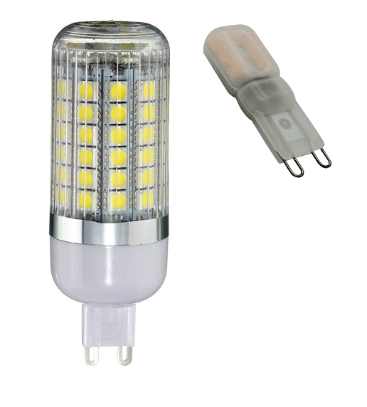

Having no neutral seems to work OK with a BA22d bulb, but smaller bulbs had a problem the smaller of the two bulbs G9-comp.jpgneeded a load capacitor load-capacitor.jpgin the light or it would not switch off.
Remember - only IF the lights are on the same circuit.

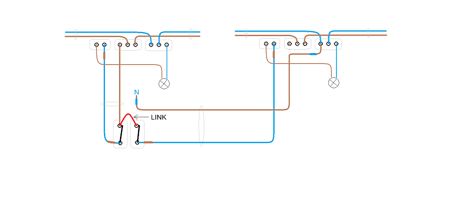

You need to go from this:
To this:
Make sure you choose the right brown wire - the one in the same cable as the switched live blue.
I cannot tell which is which from the pictures.
I have shown the bare minimum changes but obviously it would be better to swap the blue and brown so that the blue is the new neutral.

The relay DSC_6062.jpg allows you to combine switch and app, the two wires shown at top of relay go to switch, and switch becomes extra low voltage, it monitors change of state, does not matter if switch on or off, the change will cause relay to switch, so it combines the app and existing switch/es together so either can turn lights on or off.
I use the relay with just one set of lamps, as it allowed me to separate the lamps into outer and inner so I can independently switch them. With most lamps best option seems to be the smart bulb, no worries about if it will work with the switch, only when there are multi-bulbs do you need to smart switch.

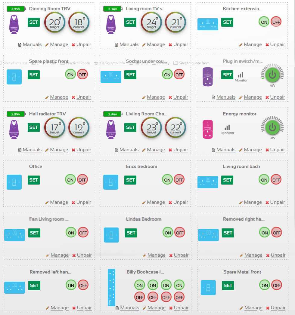

I fitted the first Energenie switch light_switch.jpg in my mothers house in the bedroom I used using a remote control Remote control.jpgsince no two way switching and it worked A1 for the three years we lived with my mother to look after her, nothing done other than fit switch, had a 12 watt LED BA22d bulb, and very satisfied the way it worked.
I also had a double socket, and some TRV heads all using same system. Again worked very well.
When I moved to this house all energenie stuff removed from mothers house and brought here, and HomeBase were selling off energenie stuff so bought a load more. Mihome-used-crop.jpg This is when the problems started, of the 5 switches fitted, only one gave a problem to start with, so first added the load capacitor load-capacitor.jpgbut still got a shimmer when on, so changed bulbs the small one G9-comp.jpghad the shimmer, the large one worked A1, had some shimmer with GU10 bulbs, but only real problem was with the G9 bulbs, the E14 bulbs were OK as were the BA22d bulbs, the problem was the small G9 LED bulbs, putting just one quartz bulb with other 4 LED also worked A1, but did not really want tungsten bulbs.
Over the next year every so often the living room switch would stop working, if I turned off the power, and switched it back on it would work OK again, I think due to number of devices I have, but removed the switch in living room, and over the next year removed two more switches so now only 2 still in use, and a socket which seemed to turn itself into a flasher unit.
Since removing the 4 devices the rest have worked A1, but when Lidi did their smart range which uses Zigbee I started using Zigbee instead, the zigbee does not seem to work from the PC very well, but tablet and phone it works well with, now have 18 devices using Zigbee and the Smart Life app.
The Zigbee devices show in app if on or off, the energenie does not, every so often I have to reboot the energenie hub, never had a problem with zigbee, but the energenie remote control works direct and does not need the hub, and having the remote control at the side of bed works well. The remote control with Lidi will not work the relay, only the bulbs, some bulbs work through the hub, and some work direct to app Smart Life, I can't remember which are which.

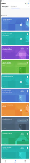

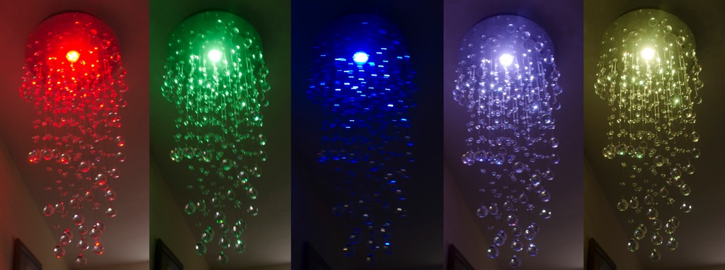

There seems to be all sorts you can do, Automation.jpg but I found not all items have the ability to do all functions, it seems to vary make to make, however as yet touch wood, only one smart bulb has failed, I got a pair of GU10 colour changing bulbs for the centre of the chandelier shown on previous post, and one of pair failed.
I have not had many LED bulbs and tubes fail, can count on one hand, so would prefer to use smart bulbs when I can, as if anything does go wrong, it is easy to correct, simply unplug and replace, where when the light switch went wrong, I had to switch off all lighting power to replace the switch.

By the way, that second rose with all the fluffy grey bits, is that normal, doesn't matter or unsafe?
I see you have asked in another thread.
I didn't think anything when I first saw it - just dirty - brush and vacuum it.
To this:
I would rewire the brown wire the switched live and the blue wire the neutral. Get rid of the sleeves.
