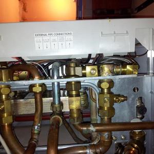

    Vaillant combi boiler CH but no hot water
    Easy flow you are a star!!! Bang on mate! The culprit was indeed the descaler The descaler cover turned out to be bust. There are two little red buttons either side used to remove cover for topping up with descaler balls. one button had been pushed in with excessive force and was...
    The story on the boiler is that it is othetwise fine but for no water flow. It has been like this for some time and they asked me if I could have a look. As I say the CH is fine, I am going round in the morning to check if it might be a descaler blockage. I presume if I open the filling loop and...
    Many thanks - boiler is not actually mine, I shall concentrate my attention on the descaler as my next task :-)
    I assume you mean the valve on the cold water supply pipe below the boiler? This is ON (big red handle in line with pipe) but it goes through an electric descaler thingy before reaching the boiler - could it be that which is preventing water even getting to the boiler?
    Hi all ...no hot water as in no flow, at all. No flow from any hot tap in the house. I've seen quite a few fixes on DIYnot for this one, and (unless I am doing it wrong) it's not a simple valve left closed after refilling the central heating, as others have had. pic below if this helps...
