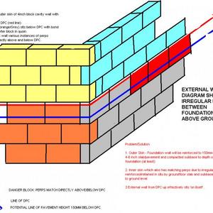

    Builders vs. Brickies (Bonding)
    Where the foundation wall in question is almost completly (bar 150mm on external side) reinforced by solid mass i.e. floor slab and compacted subbase on inside and pavement slab (metre wide roughly) and subbase and retaining wall on outside....... where will my troubles likely occur? Will it be...

    Irregular Bond Please Help (Diagram Included)
    Please can someone help with this from a structural perspective, my foundation walls and external/internal above ground walls have matching perps in many places (two inexperienced blocklayers = one problem) http://www.diynot.com/network/smarties/albums/ The diagram above is in my images in...
