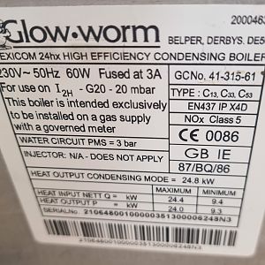

    24HX GlowWorm new electrode longer than original (2005) version and doesn't fit
    Thanks Razor - am getting that distinct impression from the discussions I've found on here!
    Hi all, thanks again for your help! For anyone else who reads this having seen the same issue we did try a couple of things 1) Bending the pair of electrodes very slightly allowed the electrode to align at right angles to the case which allowed the ceramic to pass the small metal shoulder just...
    Hi all, the GC No. is 41-315-61, I'll try and get the whole sticker uploaded so I can post that too Thanks ScottishGasMan - my gas man said the same, not sure if I'm just really unlucky.. Thanks Chris - GC No. above BoilerDetails by trevw posted 1 Apr 2022 at 5:17 PM
    Hi Chris, thanks - so I may need to get my gas fitter to post this question, or would there be professional forums he might use? He's a friend so he may be willing to do this. He is the one who was talking to Glow Worm not me, I was assuming they weren't helpful because the boiler is beyond its...
    Hi, we bought our boiler (GlowWorm 24HX) around 2005. When we had it serviced recently the electrode fell to bits. On getting the 'correct' replacement we found it didn't fit, the ceramic insulator around the electrode is too long and fouls on a shoulder of some kind in the heat exchanger...
