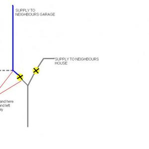

    Neighbour cut off my water.
    The stopcocks fully open, but I thought it may cause a restiction as it wont be as free flowing as the original piece of 1" pipe thats been cut out.

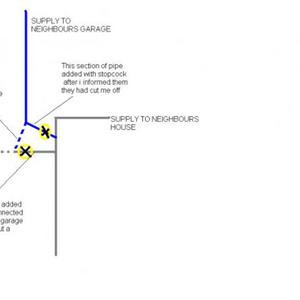

  4. S
    The stopcock would only have to be removed and a straight coupler put in it's place to put things back as they were. Reading between the lines I think the plumber left the stopcock in place so he didn't have to work on it live. I've added a picture to make it clearer.

  7. S
    Been round to see neighbour but not in so had a look at what he had done. He's fitted an access cover tube over the stopcock the plumber fitted to my supply pipe but I'm not happy as my water pressure seems down a bit and surely an extra stopcock will cause a restriction. I don't want to...
  8. S
    I going to ask him today to put it back to how it was as you've said I didn't think he was allowed to put a stop cock on my supply then cover it even if it is on his property. The plumber cut into the lead mains pipe live according to neighbour so I guess he would have to do the same again...
  9. S
    Believe me I really felt like doing just that at the time. :x
  10. S
    My next door neighbour had a plumber round today to break into what he thought was his incoming supply . Very annoying as I was in the shower at the time and thought something had gone wrong with it not realising the cold supply had been cut off for quite some time after I had checked out the...
