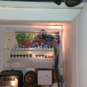

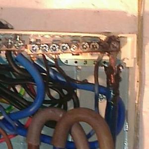

    circuit breaker loose wires burned
    Hello all, bad smell traced it to the breaker ,was very hot and melting plastic in top right corner, so called a spark asap he said it was loose wires there , he tightened them up and now it works fine but is coming back to install a whole new box system. would it be ok to leave it as it...
  3. overveiew
    overveiew
  4. close up
    close up
  5. burnt wires
    burnt wires

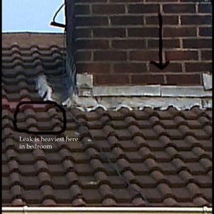

    leaking chimney mortar?
    Hi everyone, long time no log in! Anyways Bad leaks in the bedroom during driving rain ,played detective a bit but am reluctant to play spider man on the roof,at my age. Took a photo do you think this is the culprit? had the house repointed about 3 years ago but they didnt do the chimney...
  8. mortar
    mortar
    this is it anyway if i get it up for you before the summer!!
