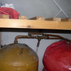

    advice on two HW cyclinder set-up.
    Hmm I see. The tank stat is already linked to a valve down with the boiler (along with one valve for lower 2 floors, one for upper two floors and one for the kitchen UFH). the suggestion would be to leave existing value open and install the valves near the tanks (though there isn't much room...
  2. M
    I would get a pro in for that as I wouldn't know how, but cheaper than replacing cylinder. would have been a good idea when the boiler was replaced, but the boiler is in the cellar and the tanks are on the 2nd floor. Wife would not be happy about uprooting the whole house (coil flow/return...
  3. M
    Thanks. We did look into unvented system when we upgraded boiler a couple of years ago (most plumbers said leave the tanks as the are, but the one that suggested new unvented cylinder quoted £16000 :lol: - got the boiler and controls upgraded and relocated for £4000 to which I added wetUFH in...
  4. M
    currently I think the HW Cylinders are both 1050x400 SO to replace and do properly I would need..!? to run 2 bathrooms both with powershowers HW 210L CW 80 Gal to allow for expansion for later additional en-suite HW 250L CW 100Gal (biggest CW tank I can find that might fit into...
  5. M
    Having checked again the tank coils are linked in parallel (flow split to both tanks, outlets join to one return). CE why do you think Left will draw faster (because the connection is closer!?) Its hard so see in photo but there is a sort of double loop, so both top outlets are joined in...
  6. M
    No it's not the way I would do it either, but thats whats there, so unless I spend the time and money to replace the whole thing thats what I've got to work with. The set up was like that when we moved in and has not caused any problems in 4yrs. (same heating loop runs through both tanks and...
  7. M
    Hi Refitting main bathroom and adding power shower (with body jets). Second bathroom (for the kids) already has a powered shower, so am upgrading existing pump to run both rooms (as existing pump is old and noisy anyway). Here is a pic. Fitting new salamander ESP 100 and they state...
