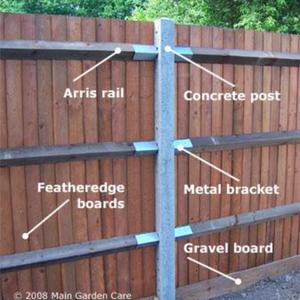

    Closeboard fence advice
    Thanks. I thought as much but just wanted to check first. Had to quickly build a fence the weekend at my wifes salon due to a break in and used the 125mm boards. Does makes the maths much easier.
    I will be building a 25m closeboard fence, probably similar construction to the attached image except with metal posts. The boards will be 2.4m high and I will probable have a horizontal board along the bottom. I noticed they seem to come in two widths 125mm or 150mm. Is there much of a...
