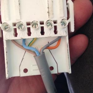

    Potterton Prima 60F Boiler banging!
    I think I've found the problem! For some reason something told me to check the plumber's wiring for the two new zone valves. I opened up the central heating connectors and they were wired correctly but the hot water one wasn't! The grey and orange wires were wired together in one hole! Here's...
