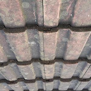

    Roof tile identification help
    I think they're Redland Renown and may have found some near me. Good idea with looking underneath, will do so next opportunity.
  11. P
    Can anyone help me identify this roof tile please. Approx. Dimensions are 418mm x 330mm. Thanks
