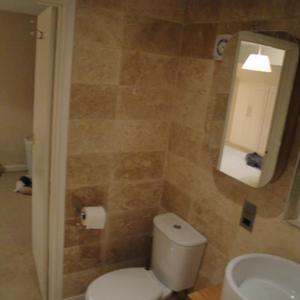

  5. En-suite
    En-suite
    Complete renovation of my en-suite
