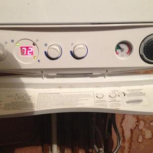

    Water pressure suddenly dropped
    Just tried closing and re opening the stop clock and it does seem a bit better upstairs but downstairs still poor, wouldn't say back o how it was on either I'm also open to suggestions for increasing the hot water pressure so don't feel your giving the wrong info it all helps :)
    Here's some photos that will hopefully help you guys..
    I did at one point yea but its now fully to the left (open) so I'm surprised if its that... Unless I've done something to it but it seemed to be fine
    I'm talking about the cold feed primarily but even the hot isn't great although I kinda expected that as its not the most expensive boiler ever! The cold feed used to be fantastic but all of a sudden it's not great
    Hi guys, I've been renovating my bathroom recently so my water has been going off alot getting drained etc.. I changed my shower from electric to mixer and I've added a towel rail to my central heating.. Since adding the radiator (nothing to do with taps) whenever I run the water on my...
