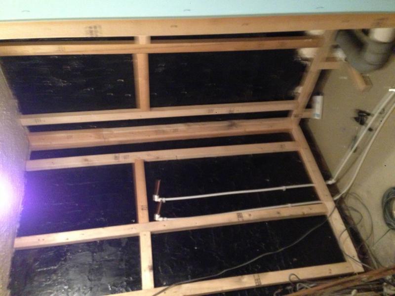

Is this okay to do?
What are the benefits of plastering the plasterboard first??
I'm not the worst plasterer in the world, I've done a few rooms previous to this but the walls are never absolutely perfect. (Sometimes slightly un-even or divets in them) so if It doesn't really make any difference then id rather save time and money by tiling directly onto the plasterboard.. I've bought moisture board for the bits directly behind and to the side of the shower so I'm just wondering if there's much point in plastering them with multi finish first??

I've uploaded pictures of the area I've got to do, do you think I could get away with just boarding the back wall where the shower will be (a corner bath is being installed into the corner the shower will be over it)
To board that entire square area with aqua panel is going to cost me about another £130
Alternatively is there a cheap tanking solution your aware of?
I tanked the brick wall and old plaster walls behind the stud with a wickes waterproof membrane but it doesn't say it can be used on board...
Thanks in advance for all your help!
Thanks for your help, screwfix sell a showerproofing kit by mapei for £45 which I presume is the same thing??
There's no shower tray going in, it's a corner bath and the shower is above it but I presume it's the exact same principle
Tape the bath edge, paint all surrounding walls and then tile

As said before tanking is an ideal solution to your plasterboars
Aqua board or any cement based boards are water proof ,but the joints where they meet one another are not !
these need to be tanked as well to stop any water getting through and rotting the timber
