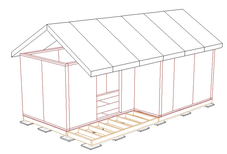

I'll be finding out because I'm intending to use them on a 25sqm DIY garden room next year - priced up from sipsdirect, there is a premium over building up a traditional stud frame and insulating and sheeting it, but as far as I can see so far the premium isn't huge and the time saving factor, even DIY looks interesting.

It's not so massive. 120mm SIP is ~£100+VAT made up of 2 sheets of OSB + sheet insulation + stud frame or glue to hold it all together is ~£50-60. I'm only intending to use sips for full wall sections - I will fabricate gables and around windows. I can also use very lightly supported SIP roof which will reduce roofing timbers, so yes, the uplift will be in the low-mid £100s but benefits in quick and accurate construction. Still very much a work in progress, but the CADs I've just started doing are based on SIPs.
