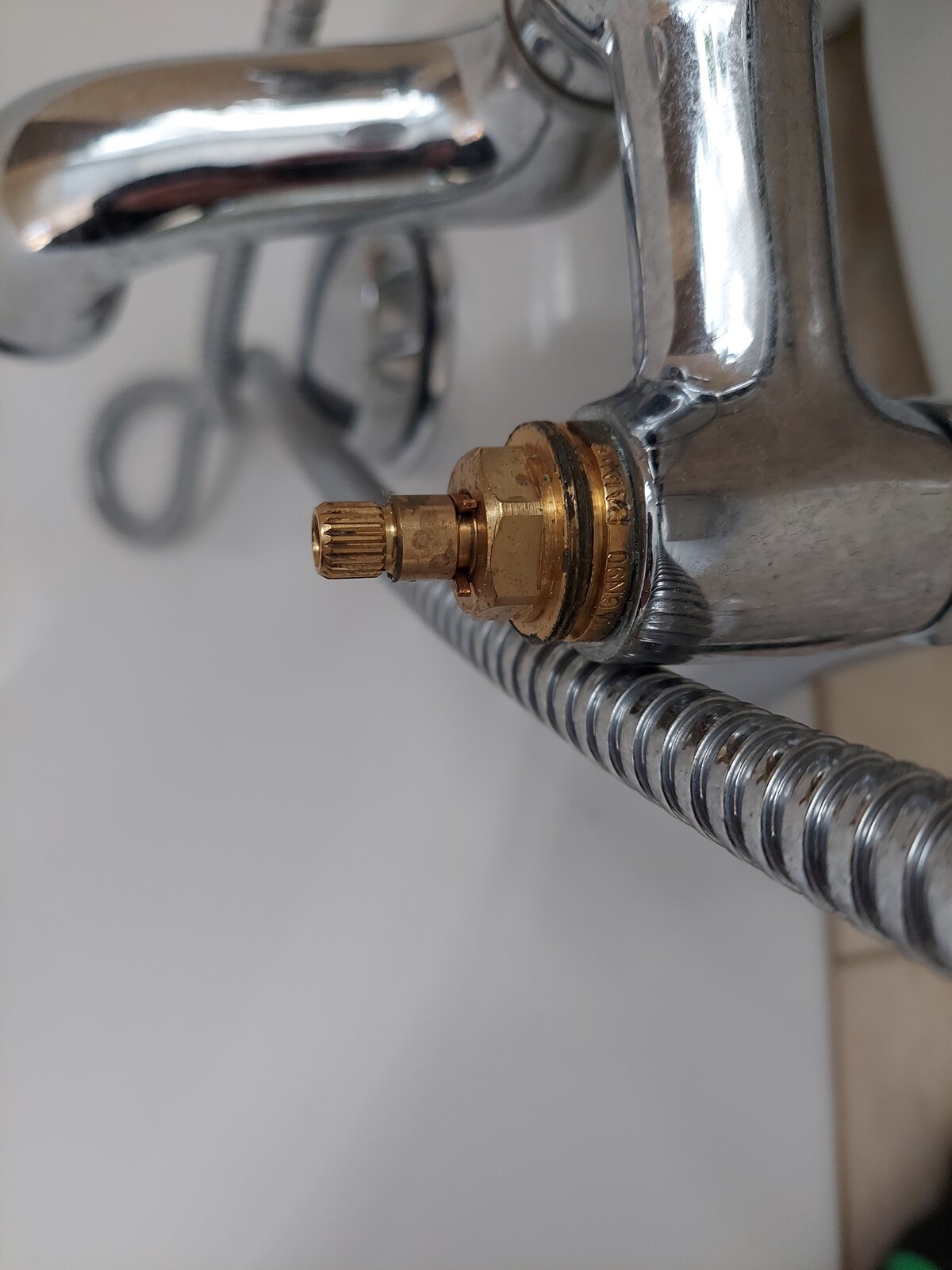

Are these taps prone to making the hot water run cold on a combi ? i have had to turn them back slightly from full to keep the water running hot.
i shower mostly but they are irritating when i do fancy a bath :LOL:
can i just change the cartridges to full ones will these from toolstation work ?
this is what they have already.

The bath tap will be a much higher flow than your other sink/basin taps, by increasing the flow to the bath tap you have also increased the cold flow through your boiler and now your combi boiler can't keep up.
The combi is set to give a certain amount of flow @ L/Min at a 35deg rise (see the MI), if you exceed that flow through the boiler it then doesn't have a high enough KW input rating to raise the increased flow of cold water to the same levels, so the HW temp will decrease exponentially, especially in the winter when the mains cold water is anywhere up to 10deg cooler than in the summer.

true but this is a high flow combi boiler with a built in tank and it worked perfectly for 13 years prior.
Didn't have that key piece of info .... When running a bath it will be using up all the stored water, the boiler should then shift into combi mode. Either it's not keeping up as suggested or if it's cold cold then it may not even be switching into combi mode. What boiler is it?

It`s a Worcester 440 high flow. i would agree after the tank has been depleted it cannot seem to keep up i don't even put the water that hot at setting 2 52c to 54c. plate heat exchanger has already been changed i noticed the central heating is not getting as hot now either on setting 5 as it was before they changed it.
They're usually pretty good even in combi mode, hence their high L/Min figures so it sounds like something isn't right.

I've yet to see the combi that will deliver hot water to the bath through 3/4" taps ( and probably 22mm pipework) at anything above 1/3rd capacity. Just allow a little more time to fill your bath. If it has been running OK for some years, then you may have reached the point where the hot water heat exchanger has scaled up sufficiently to affect performance.
