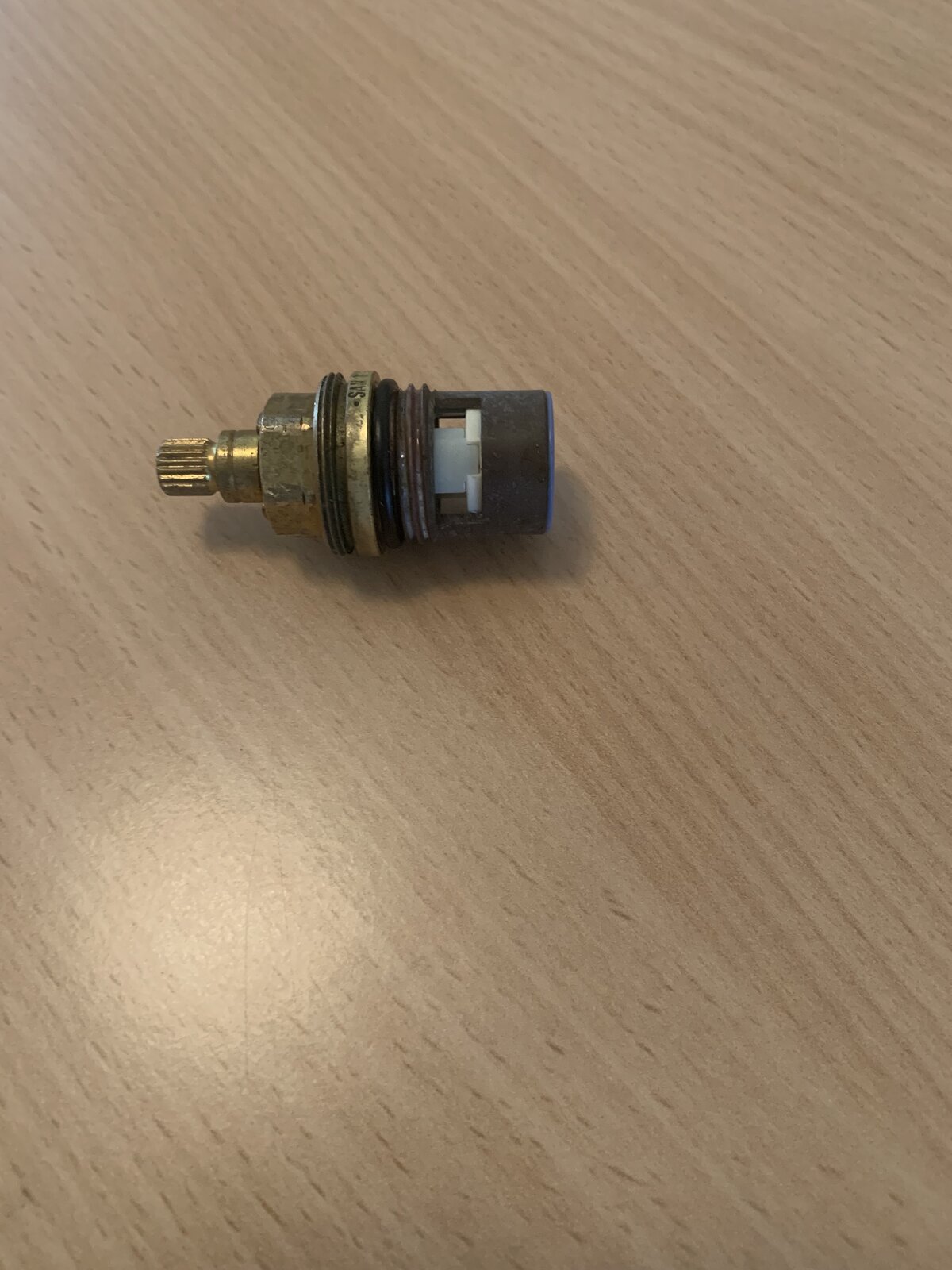

When I turn the head on the gland, I can see the insert inside the gland moving from the open to the closed position and vice versa.
Also, when I blow into the gland when it's in the open position, the air comes through it. When I blow into it in the closed position, absolutely no air comes through it.
I've tried to photograph it in the open and closed positions but you can't really see this on the photos but the gland does seem to be working as it should and as I say, I swapped the glands over and the other gland that was working as it should in the hot side of the tap, didn't turn the water off on the cold side of the tap.

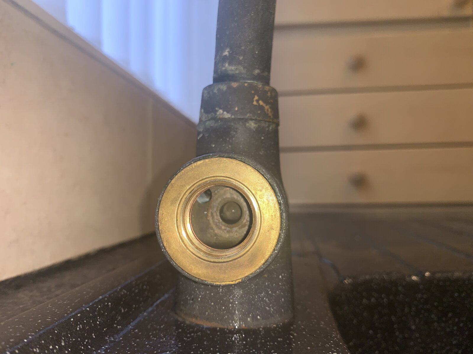

This suggests that on the cold side, a gland cannot turn the water supply off because there is damage in the tap seat, i.e. water can get through even when the tap is properly closed. Can you see any damage within the tap on the cold side that could be causing this?
I can't see any obvious signs of damage within the tap but I am not 100% sure what type of damage I'm looking for. I don't know if you can tell if there's damage, from the photos below.

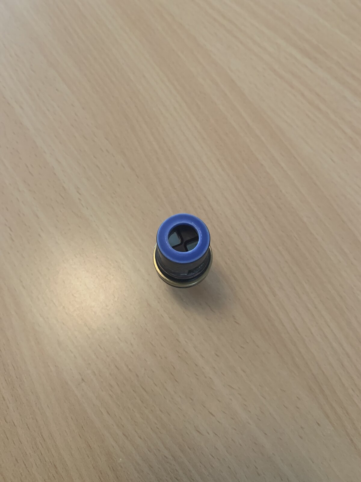

Try a thinnner O-ring/ rubber washer on the cartridge, so that the blue seal can press fully against the valve seat.

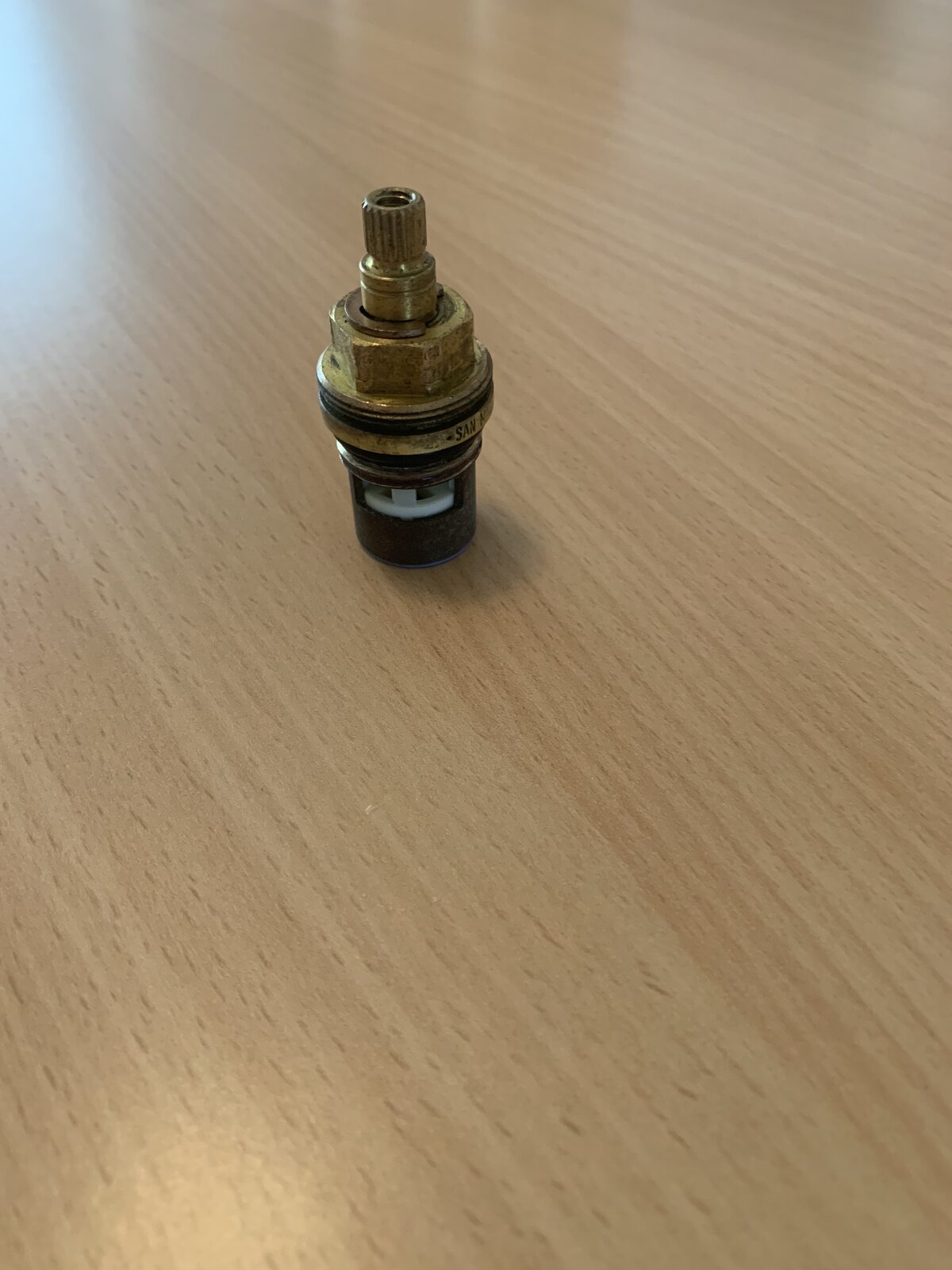

Is the cartridge that you refer to the same thing that I am calling the gland? ie the brass unit that screws into the tap itself that I have pictured below.
Also, where is the 'valve seat' located?
Is it the black O-ring/rubber washer that is shown (mid-way down the gland) in the above photo what you are suggesting I should replace with a thinner one or is it somewhere else?

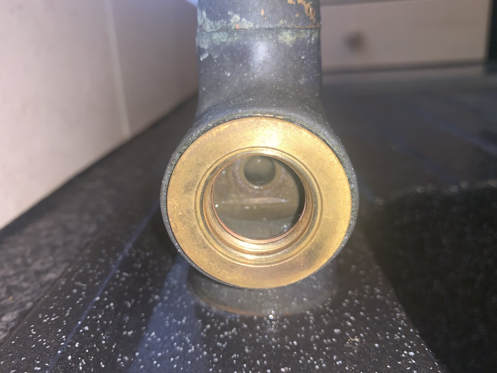

Ok, so I removed the O-ring/rubber washer altogether from the gland and I checked that the gland was in the closed position before refitting it into the cold water side of the tap. Removing the O-ring/rubber washer from the gland should mean that when it is screwed in, the gland sits slightly further into the tap body than it did before, effectively meaning that the blue seal at the end of the gland has a better chance of closing-up against the inside of the tap to create a seal against the hole inside the tap (The hole that is shown in the photo below).
I then turned the cold water supply back on via the ball-o-fix valve and water started running from the tap head. I moved the tap on/off lever to its opposite way but it made no difference, so removing the O-ring/rubber washer didn’t work.
I then reduced the cold water supply flow through the tap by turning the ball-o-fix valve and I unscrewed the gland from the tap body and removed it. Water was then obviously coming out of the opening in the tap where the gland screws into. I put my finger inside the tap to fully seal the hole inside the tap that can be seen in the photo above and no water water flowed out of the tap head (as though I had turned the tap off). When I took my finger off the hole inside the tap, water started flowing again from the opening in the tap where the gland screws into.
It appears as though for whatever reason, neither of the existing glands that I have tried are properly sealing the hole in the tap body on the cold side.
Is there anything else that I can try?
Cartridge=gland.
The O-ring is halfway down the gland.
The valve seat is in the tap housing and shown in post #11.
