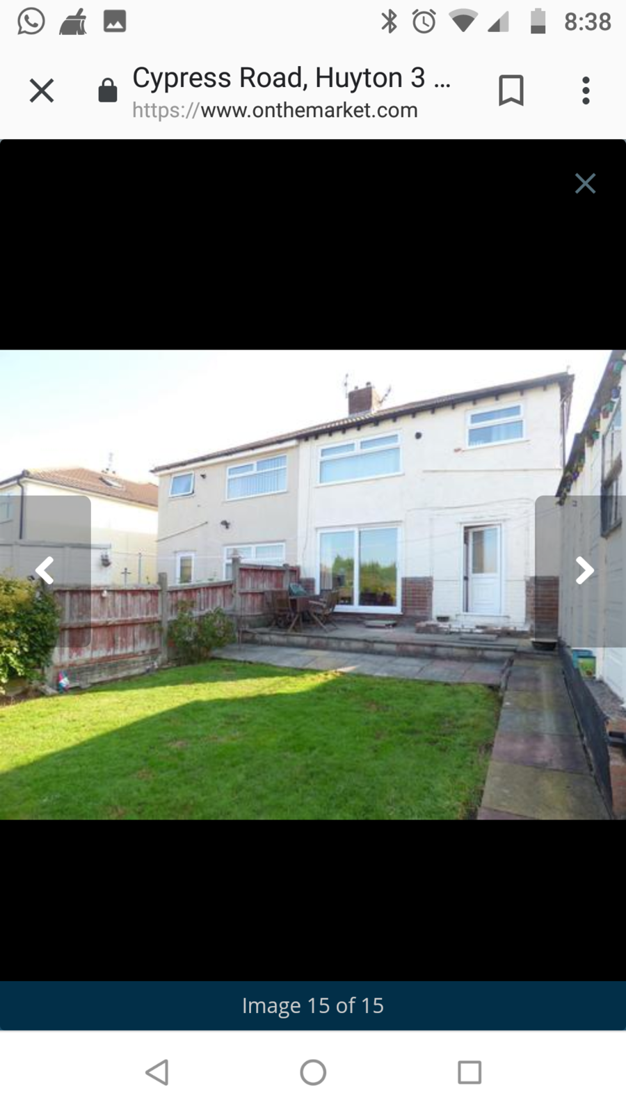

Back of house. Wall is between patio an single door

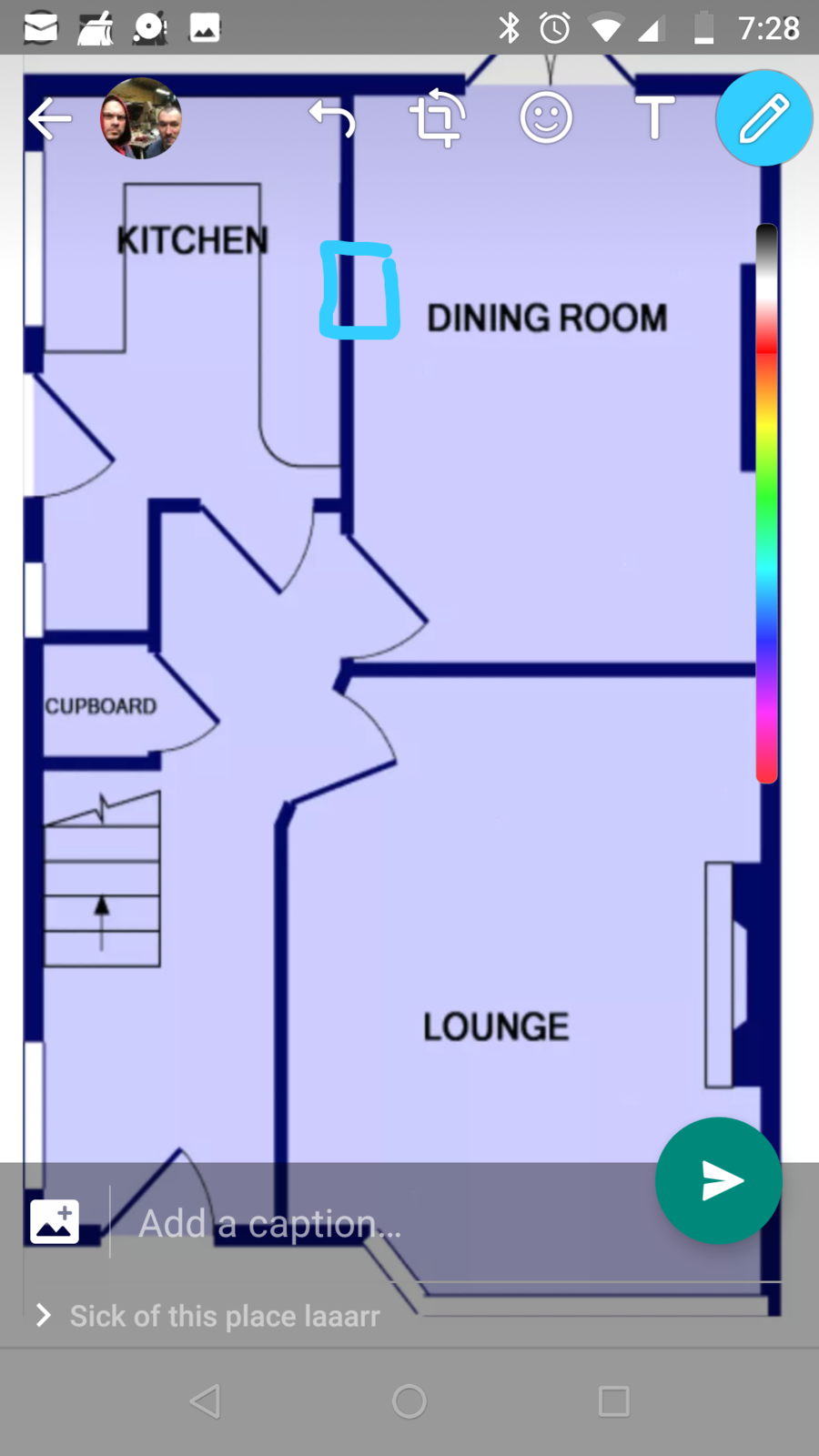

Similar plan to mine. Blue square is where there is 2 blocks in loft at top of this wall with the roof beam resting on that runs through the 2 houses

There's a decent length of wall between the kitchen and lounge doors, so no worries about the wall being able to take the vertical load from the beam.
The inspector raised the issue of lateral stability, possibly because your floor joists seem to run parallel to the wall rather than into it (if they run into the wall, they provide some lateral restraint to the wall in high winds and help prevent the wall being sucked out). His reasoning is probably that the ground floor wall acted as a buttress support to the rear wall.
Two things come to mind; if the wall between the bedroom/bathroom(?) upstairs is a load-bearing wall, that will - or should - be bonded to the external wall and will give a degree of support. Second, if you got some metal restraint straps screwed to the underside of the floor joists and the rear wall - equally-spaced along the wall - that would give a mechanical fixing to the wall (surprising as it may seem, floors are often depended on to give support to walls due to their inherent rigidity).
Perhaps put that to your inspector and see if he will agree to that?

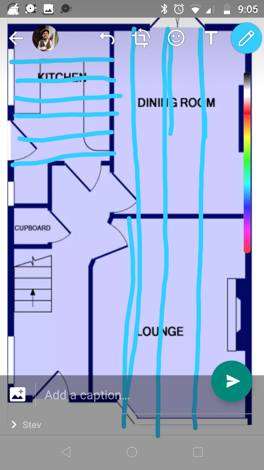

Thanks for explaining some details. This is how the joists run in the house
If that's the case, just fix 2 or 3 straps to the joists over the kitchen and screwed to the outer wall.

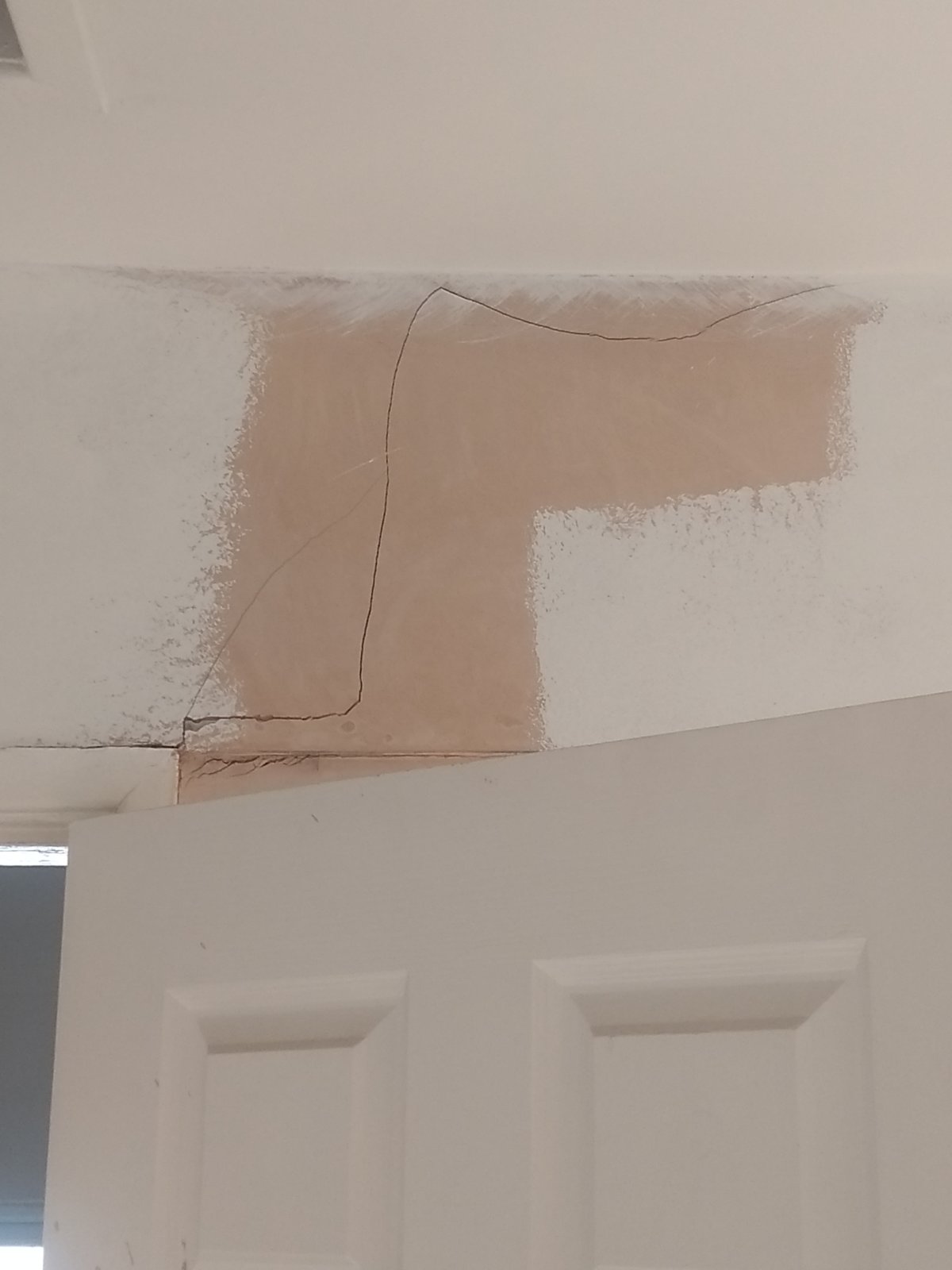

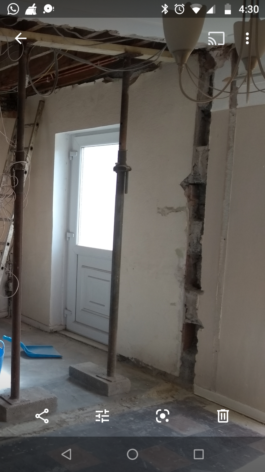

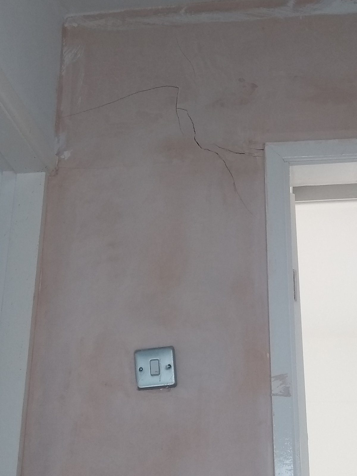

Any suggestions how this could be fixed. Don't think it's been propped properly door frame has dropped a little aswell
