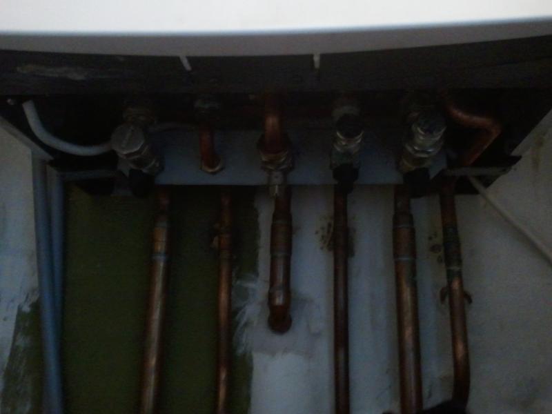

hi guys
i have a baxi combi 105e combi boiler with low pressure im either being really stupid or its more complicated than everyone says on this model i cannot locate the filling tap to repressurise.anyone have any answers?
Can you post a picture of the underside of the boiler? The filling loop may (should) have been disconnected so maybe it's not very obvious where it goes.

Edit: found the image......
Hard to see clearly but are there black plastic screw-on covers on the two connections to the right hand side.
I think a flexible filling loop should connect between these and then both taps on the underside of these valves will need to be briefly opened.
This particular boiled does not have an itergrated filler loop built in.
If you look for a flexible braided hose beneath the boiled fitted to a 15mm pipe that leads to a bigger 22mm pipe the filler loop is connected.
There will be either a wahing machine tap fitted to it or a ballafix flat screw type fitted, turn this slowly and the pressure on the boiler will rise, once 1.5 bar is reached turn off the the tap.
If the filler loop is not fitted (no flexible braided hose present), one will have to be fitted to re pressurise boiler.
