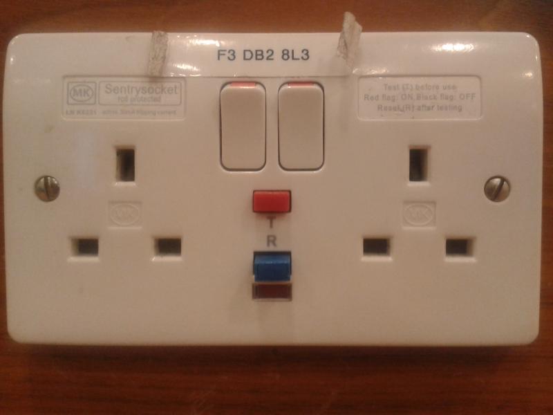

London City Airport 2013:
Somebody found it necessary to put an RCD in the sockets where dumb tourists frequently do the ball pen trick to get their laptops plugged in. And all the other sockets in the building?

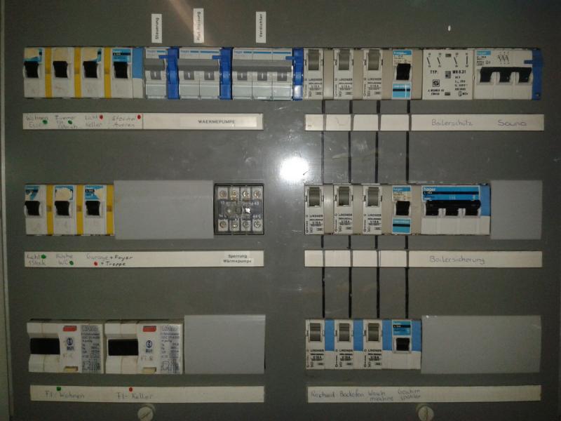

The distribution panel in the basement of my house dated early 1980s:
There are two 4 pole 30mA RCDs, one for the living area, one for the basement and the garage. Look at the label saying 380V. They are really from that time. All sockets, lamps, whatever are secured, whenever there is the slightest ground fault, all 3 phases and the neutral are shut off in the whole area. Excempt are only the heat pump central heating and the central hot water boiler, both 400V 3 phase, which are fix wired by a certified electrician without any user accessible plugs.
Over here every kid knows that the lights will go off if you drop the hair dryer in the bath tub, but daddy said it is dangerous anyway, so don't ever do that.
My mother in law recently tested those unvoluntarily. The old school houswife cleaned the tiled kitchen walls with a wet cloth. She didn't get a shock, she didn't even realize, she was the reason for the blackout. By switching the different fuses on and trying to engage the RCD I could locate the problem to the kitchen. It took more than 24h until the socket was dry enough to keep the RCD from triggering. Now she knows why not to use wet cloths on sockets... Guess: Because the lights will go off for a while ;)
And that would fall afoul of current regulations. Also common sense.
Here it would, but I know nothing about Swiss regulations, and not much more about Swiss common sense!

And an RCD never triggers unless there is something terribly wrong with your wiring or the appliance plugged in and very likely dangerous to touch. When I bought the house it came with an electricians test result about the total ground fault of the installation. It was below measurable. The units in the form were microAmpere (micro not mili).
I think you cannot run a unsecured pure nature socket that will only shut off at 16A or whatever it's rated current is and say it would be unsafe to make it safe (or say much safer) because darkness is more dangerous.
So what? The installation per se is bound not to generate its "own" earth fault currents of any magnitude, a 100MΩ IR to earth translates to 2.3μA. Take that figure up to several '00MΩ, or even GΩ (the raw performance of new cable), and you're into nA.
None of that stops every device with a SMPSU generating 3mA (or more) of leakage.
