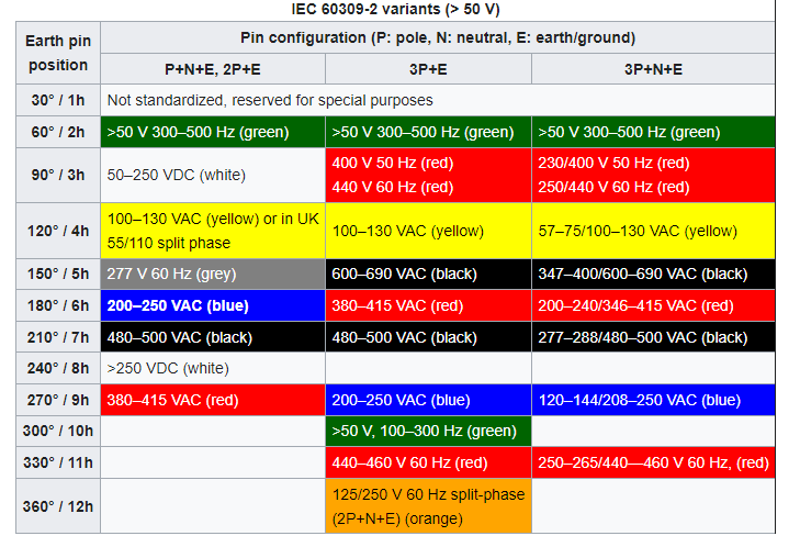

Was changing one of these today on a transformer.
The original had an extra cutout at about the 2 o clock position.
The replacement didn’t.
What is the key for ?
Not sure what you mean by cut out really.
The important bit is the bulge at 4 o clock in relation to the earth pin,
The two cut outs on the inner bit are just recesses to access the screws holding the gubbins together with the back.
Yellow plugs are stamped 4H and i believe blue ones are stamped 6H

The funny thing is, and I'd completely forgotten this until you reminded me, when I first started working with these I asked what the 4H & 6H stood for, I was told horse power.
Oh yeah your right :). Probably for the screws. I remember when making an extension lead up decades ago

There's a whole family of these. I agree that the 4h & 6h are the most common in the UK, but....
At work, we have some 9h blue 5 pin versions for 208V 3phase 60Hz.. Several times we've been told by "inspectors" that they are wrong & that blue must be 3 pin 230V :)

Yeah bl***y infuriating isn't it? That chart doesn't show them but I've fitted 5 pin orange for that exact situation.
I may very well still have some blue 4 pin 8h's where I could only source them in a box of 12.
Going back a lot of years the plugs and sockets often had the ability to set them at any of the 'h' positions. One of the jobs I worked on had sockets dedicated to particular pieces of equipment and the 'h' positions set differently to prevent incorrect connexions.
