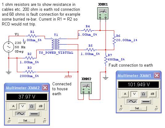

Now tell us why the fault voltage (indirect contact touch voltage) does not exceed 40 volts for any winding arrangement, single or three phase? You will need superposition theorem and lots of spare time :D.

Fault voltage Uf is the voltage, which will be found on exposed conductive parts. During a fault so if we look at a house for an example on a TT system without a earth leakage trip with 13 amp flowing to earth rod with a resistance of 10 ohms the soil pipe could have a voltage of 130 volt to true earth, hence why we must use a RCD on a TT system.
In real terms there will also be a resistance in the supply cable so it would be lower but since the 10 ohm of earth rod is only a figure taken as an example the whole calculation is not real.
If the fault was from a 110 volt transformer i.e. a phase is connected to earthed gas water pipe which is bonded to the earth rod then the voltage will be 55 volt divided by sum of system impedance and earth rod times by resistance of earth rod. So if the impedance from the transformer is 2 ohm and the earth rod is 10 ohm then the fault voltage would be 45.8 volts. If the earth rod was 20 ohm then you would get 50 volt and since an earth rod where a RCD is used can be up to 200 ohm you could get 54.5 volts. Because the 110 volt transformer isolates incoming supply from out going supply the fault would not trip any RCD on the supply which the exception of the old voltage operated type.
Normally of course water, gas, and soil pipes add to the earth rod earth and we do get lower figures in a house even on TT system.
However using a 110 volt transformer in a house does increase the danger of getting a shock rather than decrease it as intended but a house is not a construction site or farm so it is not required.
So since I have failed to show how it is below 40 volts I will pass it to “NotHimAgain” to show the maths involved.

I don't understand your fault path with a transformer plugged into a TT system, surely the fault path will be back to the 110v transformer secondary? The installation earthing/bonding will provide a path for the current to flow back to the secondary, the electrode holding the lot at or about earth potential?
When we assess fault characteristics for an RLVS, or a normal installation, we are generally concerned with faults between the line conductor (R1) and an exposed-conductive-part. This exposed-conductive-part is usually connected to the main earth terminal via a circuit protective conductor (R2).
Faults (zero impedance) between line conductors and extraneous-conductive-parts, such as your gas pipe, are far less likely, and are not generally considered. They could be, but we would need to know the impedance of the extraneous-conductive-part between the point of fault and the point of any connection to the main earth terminal. Extraneous-conductive-parts are therefore not generally included in the earth fault loop path.
So when you assess the touch voltage (Ut) for an RLVS you are concerned with the impedance of the transformer winding, the impedance of the line conductors and the impedance of the circuit protective conductor. The transformer earth reference electrode is not included in the fault current path. It does, however, provide the earth reference, and would provide a path for the touch current (It). This is the body current that actually gives the shock - see BS EN 60990:2000.
So as I said in my last post - you need superposition theorem and about ten pages of circuit analysis :D.
The principle is to consider the transformer secondary as two 55 volt circuits consisting of a line conductor and a circuit protective conductor (cpc). Various faults are applied both near the transformer and far from it (i.e. at the end of a final circuit). This is done for each 55 volt circuit and the results are superimposed to complete the analysis - its too complex to describe in detail, but the general idea is straightforward. This is also carried out for the three phase version.

Had now more time to look.
I still want to know more about the “superposition theorem” is it anything similar to Thévenin’s or Norton’s theorems? I seem to remember that one of them ended up with reams of paper work and all too easy to make one mistake.
I realise now after laying out the circuit in electronics workbench that what I was seeing in my mind’s eye was wrong.
Here is the scenario I was seeing with the results given by electronic workbench which when compared with results using Thévenin theorem in the past was quite close.
I will be first to admit in real terms unlikely to do one any permanent damage but although I can see the safety features in using split phase 110 volt on a real construction sites. However where it is used in premises where 230v from RCD protected 13 amp sockets is available I think it introduces as many dangers as it removes and in real terms it’s only advantage is one can use the same tools in both environments.
