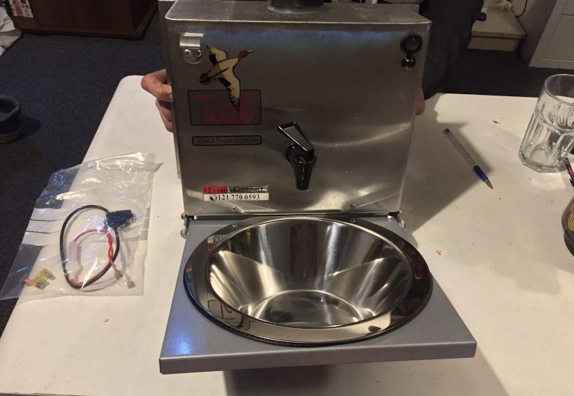

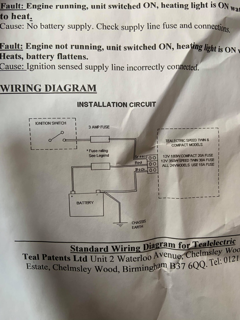

Flameport Many thanks for your help and suggestion, it’s just the ampage I’m confused with, do I go 20amp will that will be enough for the heater and a small 12v water pump?
Add the current for the heater and pump together.
You need a power supply that can provide at least that much current, preferably a bit more.
