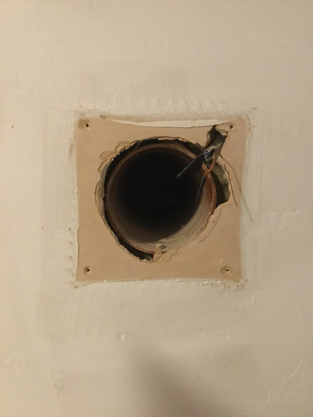

Hi. I'm currently renovating my bathroom and I want to replace the extractor fan with something a bit more modern with a brushed stainless steel look finish.
The current setup is a 12v with a transformer outside the bathroom above the door. Despite spending hours on the net and visiting 2 electrical suppliers I've not been able to find any 12v fans in the finish I'm looking for. There are plenty of 240v ones though.
So my question is, if I fit a ipx4 rated 240v fan in zone 1. Which in my case is at the far end of the bath away from the shower and taps and 1.9m from floor level, can I just bypass the transformer in the box by way of directly linking the cables to send 240v straight to the fan?

If I understand correctly, with the current setup you will have a 2-core cable carrying 12V from the (remote) transformer to the fan, not a ('mains') neutral and switched live. That cable may or may not be suitable for carrying 230V/240V to the fan. What sort of cable is it?

The core size of the cable at the fan end I’ve just measured at 1.4mm. So I think I’m good to go with a 240v fan by just connecting the cable that was going into the transformer with the one that was coming out it and bypassing the transformer?
The size of the conductor would not be an issue - apart from anything else, a 240V fan will take only about a twentieth of the current that a 12V one did. The issue is whether your current cable (carrying 12V) is adequately insulated/sheathed to be used with 230V/240V - which might well not be the case, at least in terms of 'rating'. As I asked, what sort of cable is it (what does it look like?)? A photo might help.
Kind Regards, John
Here’s a photo of the cable.
