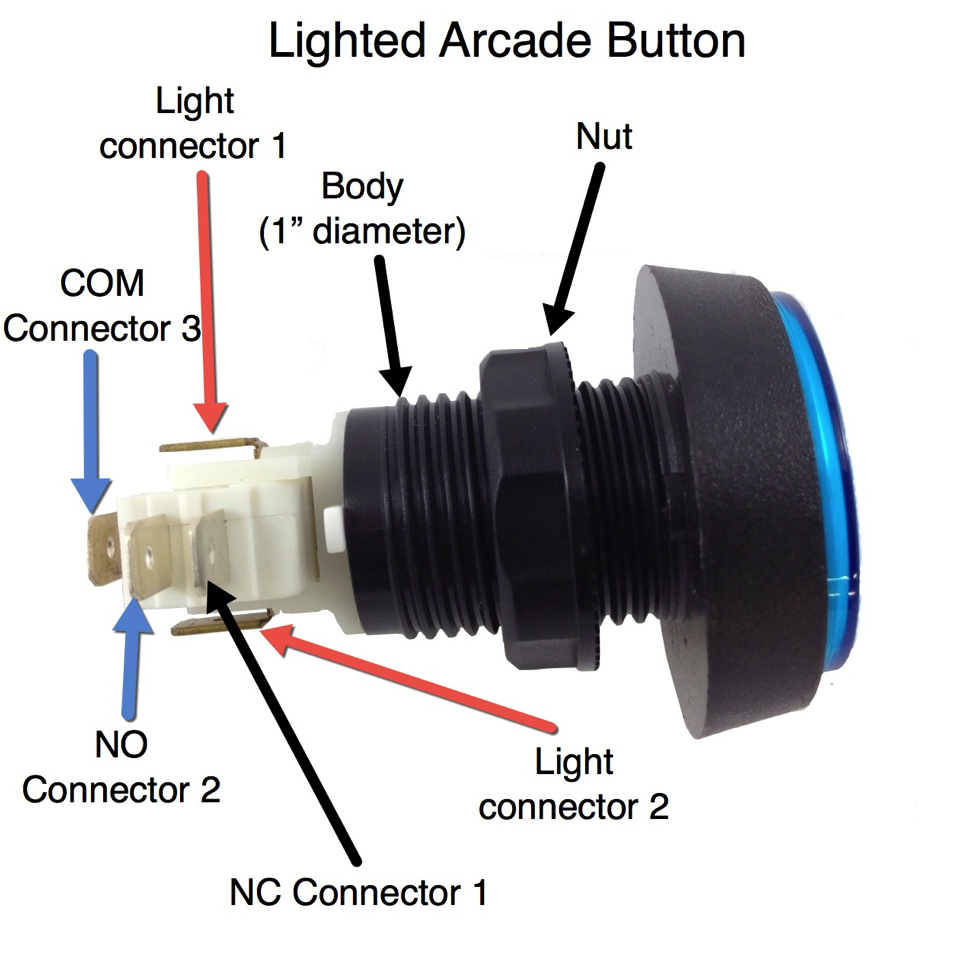

Hi All,

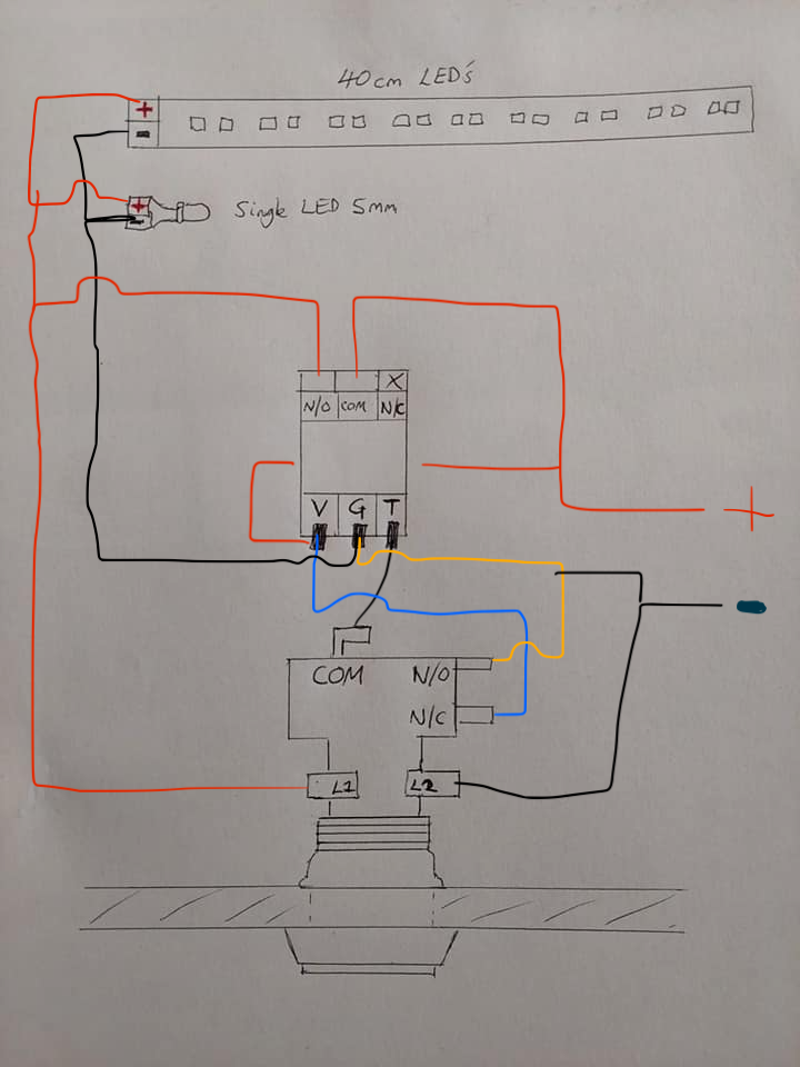

I have a momentary arcade led switch connected to a relay module to make it a latching on/off action to turn on 40cm of 12v led's (plus a single 5mm led bulb) that's powered via a DC cable. I want the LED Switch to illuminate only when the button is pushed on. I've wired it like the 1st picture but all the LED's/Bulb are constantly on and the push button doesn't turn it on or off.
Here's the relay module:
Would anyone be able to tell me how to wire it correctly please?
I added a blank diagram if that's easier to show the correct wiring.
Many Thanks!
Chris
The COM on the switch should be Live (not Ground).
Connect the COM on the switch to the V on the Relay.
There will then be your 12V supplied to the 'T' on the Relay.
When you press the switch the voltage to the 'T' with be removed (it will go from 12V to 0V) and the relay will be triggered.
This is done becuas the 'T' needs a 'Low pulse trigger'.
EDIT: - I also think the green wire should go to N/C.

I would go:
Com from the switch to t on relay.
N/C on the switch to Vcc
And N/O on switch to Gnd
That way, the trigger would constantly be receiving +V, until you press the switch.
Then, the trigger will be connected to ground for the 'low pulse'.

Hi Random,
I've wired up like you said but the button only acts as a momentary switch now. the LED's come on and the button illuminates but only if you hold the button down, rather than as a latching on/off function. Any ideas how to fix it pls? Many thanks!

Ok - sorry, I hadn't investigated your module properly :(
Our ideas would be the usual way to deal with this sort of problem.
However, your module is using electronics to simulate a latching relay - looking at circuit diagrams from similar modules, the low trigger only has be touched to ground. There is no need to stop the input floating, by connecting it to +V; it's internal electronics are compensating for that.
The problem now is, your original circuit should have worked!
Try disconnecting the +V from N/C and see what happens.
If that still doesn't work, disconnect the switch entirely (apart from the indicator light), and just bridge a wire between T and Gnd and let us know what happens.
1) Another question from me first - your drawing shows (from left to right) "V G T", but the circuit board when viewed from above is labeled "T G V". Have you got the correct wires in the correct order. From left top right the circuit board is shown as being: Trigger, Ground, 12V
2) Then Try removing the 12V from the NC on the Switch (but this is back to where you started) .
3) Then have you tested the latching relay by itself?
My next step would be to remove the latching relay from everything and test it by itself.
Connect the latching relay to Ground and to 12V via the G and V pins.
Have an extra wire from Ground and an Extra wire from 12V.
Touch these wires one after the other to the T pin and see if and when the relay latches.
Sfk
Edit - Random got there first - but I think we both said the same,
Hi Random,
Yes, I think you're right, I've wired G & V only, thinking they were N/C,COM,N/O, completely my fault. Sorry. Should i re-wire them as the previous diagram i posted and see what that does?
