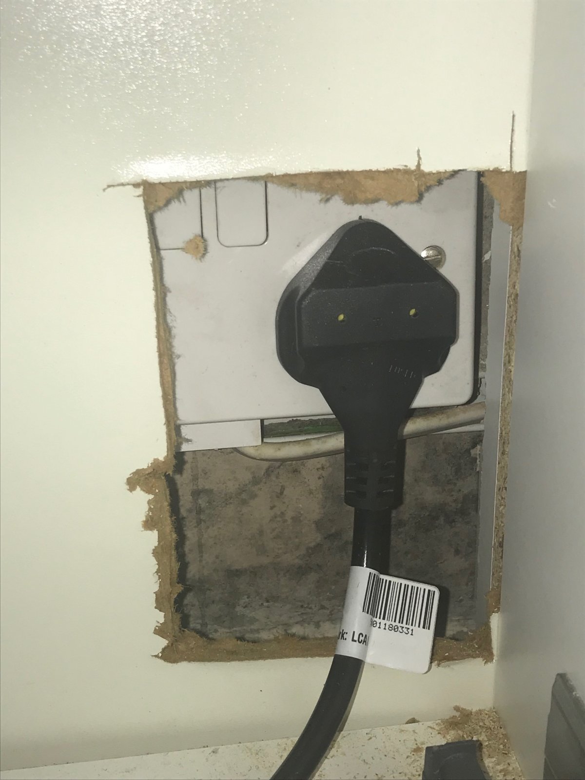

Hi all,
I hope you can help.
I have plugged in a new NEFF 13amp plug in hob to a single socket underneath. It keeps tripping when i use 2 or more rings. using 1 is fine. I worked out that its going to a B6 Legrand RCD. Do i just need to get a higher rated one like a B16? And is it a simple as turning off the ele at the board and popping the old one out?
Thanks in advance

Hi All, thanks for the replies. It was previously used for the electric oven. in the words of Charlie Sheen ' it was there and i just stuck it in' .
I think the minute I heard fire, melt and overheat an electrician is needed. Im very handy at DIY but i stay clear of electricity. Working with the old man who assured me the sockets had been 'isolated' oops except that one, made sure of that.
Its always hard to judge from a photo, but the round white wire going from the junction box tp the socket is not big enough.
6A is the max on that. Heavens alone knows what the other wiring is. I really suggest you get someone in to sort that out for you.
Rob, as TTC first stated, that circuit is not capable of handling the requirement of that hob - get an electrician in to rewire it.
Looks like 0.5mm 3 core flex to me, as TTC said - only suitable for an ignition/spark for a gas hob.
How that middle junction box that is behind the thick black incoming supply is accessed is beyond the skills of my screwdriver :)
