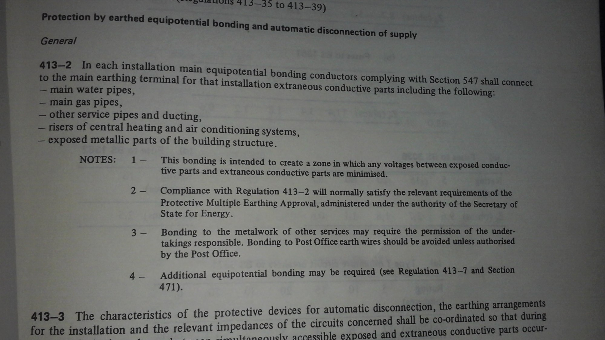

Copy of the specifications requires when requesting the use of combined neutral earth earthing terminal. Note where it says:
Equipotential bonding is required between the earth conductor and the following extraneous conductive parts:
* Water installation pipes
* Gas installation pipes .....
As EFLI said about BS7671, it would be far better if they made it clear that the list (including water and gas installations pipes) is (which it is) a list of things which may (but also may not) be extraneous conductive parts, and it's only the ones which are that require bonding.

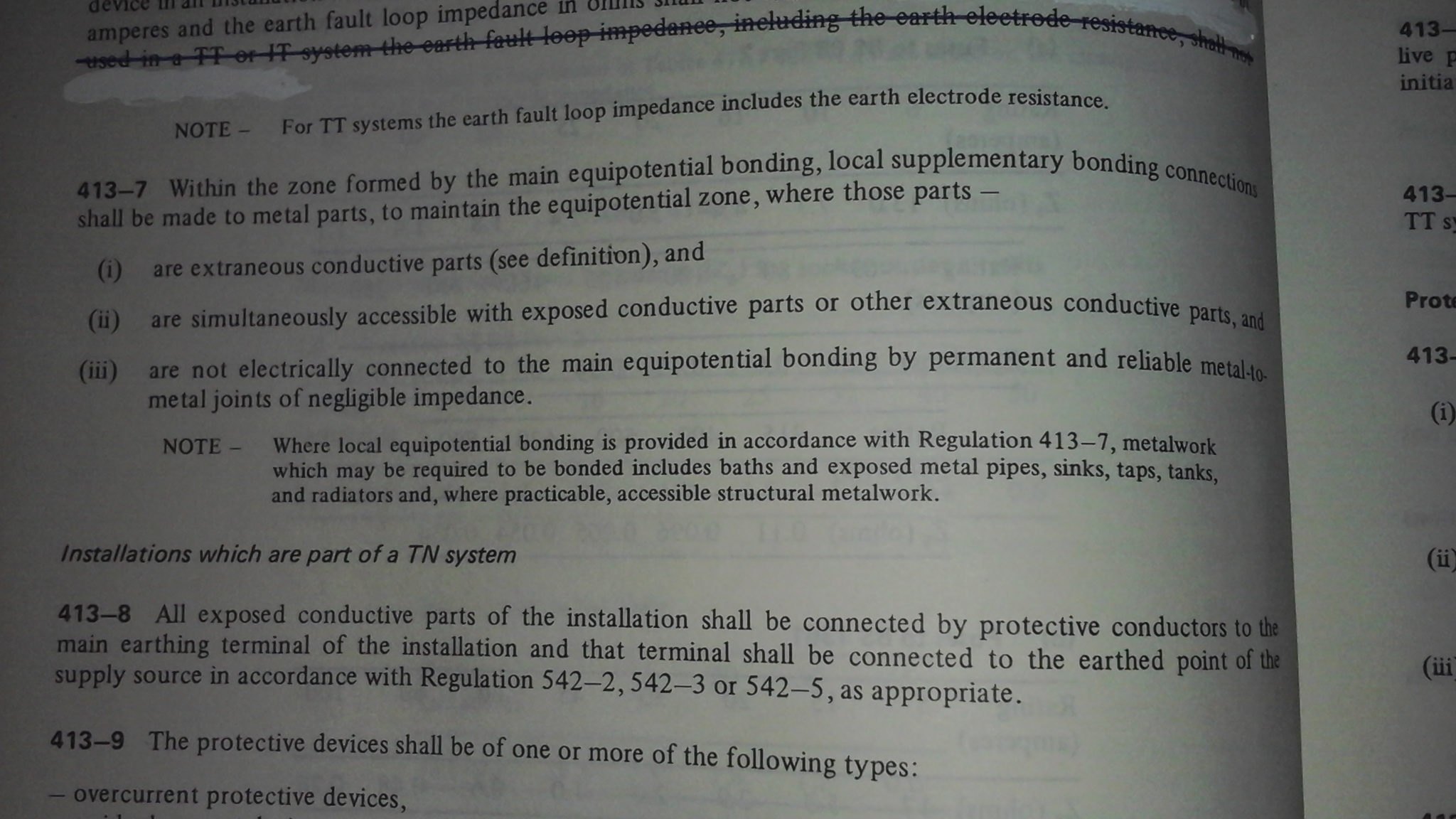

From about '73 to '77 I did a lot of new build work and I can assure everyone that the inspectors would check the resistance to earth of every single metal window and door handle and a random sample of hinges. They checked that all metal services entering a room were bonded, including the radiator. Without it the supply would not be connected.
As I recall, the regs implied something like 'all exposed metal work' and it was far too easy to interpret it far and away above it's intent. I'm totally convinced some inspectors, or their companies!, took it to ridiculous extremes but there was no power without conforming .

I posted earlier a publication, published by the IEE, relating to that question. It was dismissed as a myth saying it was written people not understanding the regulations. Farsical was written people not understanding the regulations it was written by the same people who bl00dy wrote the things!
As few posts ago details of requirements if consumers wishing to have a combined neutral earth. Despite that say they are wrong. Who is more qualified a DIY forum or all the technical expertese of the network providers and the IEE. No challenge in my opinion

That weren't a myth, that was required some time ago, the myth was people bonding door knobs and hinges etc.
But you keep chopping and changing between Main bonding and Supplementary bonding
See below other things they also wrote.
We have pointed out many times how it is you who is misreading things.
Where your Gas people only quote part of the regulations you accept that without question.

547-02-02 in 16th ed and 544.1.2 in 17th ed
The opening words in those are:
"The main equipotential bonding connection".
MEB is only connected to extraneous-conductive-parts, which is not the same as connecting it to any gas or water etc pipes you can find.
If the "gas, water or other service" is not an e-c-p, then nothing after word #6 in that regulation needs to be read, as it does not apply.
I think that takes care of why I believe internal pipework needs bonding.
so what is this connection that the second half of the reg refers to after the insulating section , if as you rightly say that bit is not extraneous.
Given what I said above, this is not an attempt to get you to understand, just a clarification for any future readers of how lacking in understanding you are:
Note where it says:
* Other installations pipework and ducting
* Central heating and air condition systems
* Exposed metallic structural parts of the building
Note where it says:
Equipotential bonding is required between the earth conductor and the following:
* Extraneous-conductive water installation pipes, not all water installation pipes.
* Extraneous-conductive gas installation pipes, not all gas installation pipes.
* Extraneous-conductive other installations pipework and ducting, not all other installations pipework and ducting.
* Extraneous-conductive central heating and air condition systems, not all central heating and air condition systems.
* Extraneous-conductive exposed metallic structural parts of the building, not all exposed metallic structural parts of the building.

Despite the fact that it can (and has been) correctly argued that if the totality of the relevant regs in BS7671 are read together, then what they are requiring in terms of main bonding is actually correct in terms of what is electrically required (and 'safe'), it worries me that those regs have clearly written in a way which has resulted in substantial numbers of people (possibly even a majority) interpreting them as meaning that they should do things things which, under certain (admittedly fairly rare) circuimstances could put the occupants of the property at risk.
It's all very well saying that if the regs are read fully and correctly, with thought and intelligence, they are 'correct', but if those regs are written in a manner such that a substantial (or high) proportion of people are interpreting them incorrectly, that surely means that the regs are not, in practice, proving to be satisfactory?
