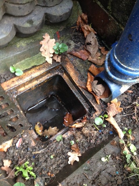

We have a house which was built in 1925 and there are 3 main stormwater drains serving the guttering downpipes from the roof. There always seems to be a set level of water showing in each, assume this is normal as flushing with a hose they seem to drain away fine but you never see them drain away completely 'empty' as it were.
Another thing, we can't seem to find where they drain to - should there be a separate manhole cover other then the only one we can find which shows the kitchen/bathroom drainage?
They probably drain into the foul sewer - a combined system - I personally would have a small bit of gutter under that shoe so all the water goes into the gulley over the grid. But then I am a bit pedantic;)
