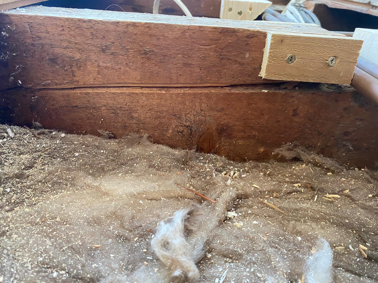

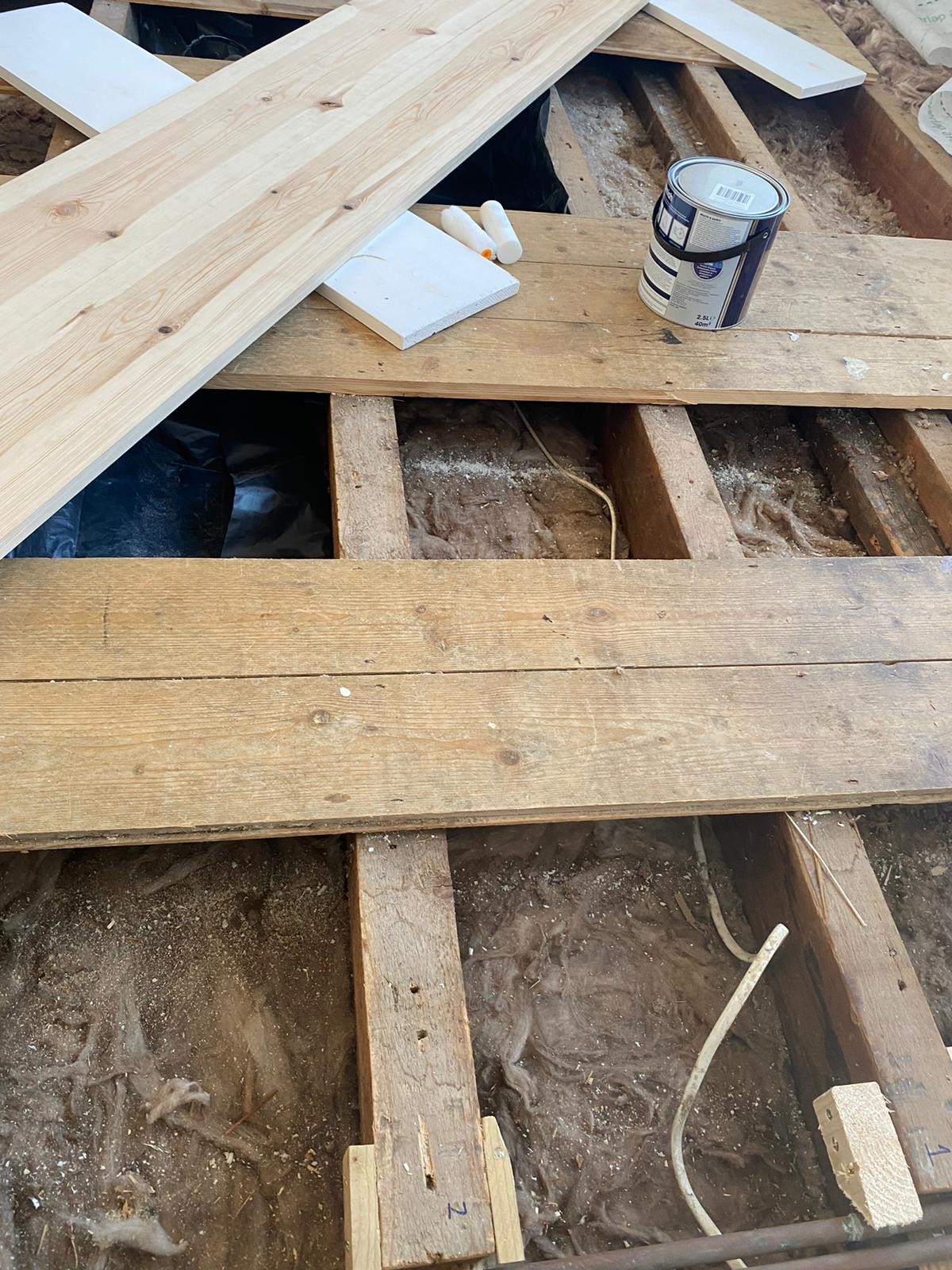

Hi All!
Doing some renovation and my brain just noticed this a joist crack, see images. Joist dimensions are 165 mm x 74 mm.
As far as I can tell, the crack runs the length of the joist within the room (3.45 m), on botch sides of the notch. Becoming more hairline after about a metre from the notch. There is a degree of twist of the joist above the crack at the notch area.

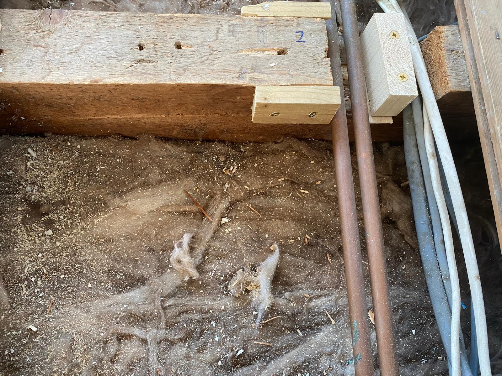

This notch cut is 55 x 108 mm. From my maths, if the rule of thumb is notch depth 0.15 x joist depth = 0.15 x 160 mm = 24.75, my notch is.. deep! My superficial understanding of the notches, they are a whole ball game in themselves. Open to your responses :|

Look up 'sistering a joist' and do that with glue, screws and plywood, or more softwood, should stop any more movement
You probably need to glue and screw a ply plate to cover the joist both sides around all those notches, and a longer piece of ply to cover that split on the joist.
It is what I expected!
Is it worth herringbone or blocking at the significant cracking point, against the twist. Then sistering the other side?

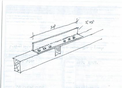

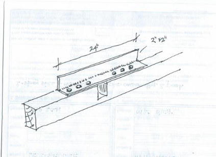

Something like this maybe (below)? notch top, metal plate and bolt down? as found in a different thread. Either bridging the notched area or just over the cracked area, or span the notch and a length over the the length of substantial cracking?
Even better!
No. Support really needs to be on the sides.
You can't put angle iron on top of a floor joist like that anyway!

I am blocking the joist against the twist, then sister the other side. As I am here, I will then block all the joists and plywood all notches that need it.
