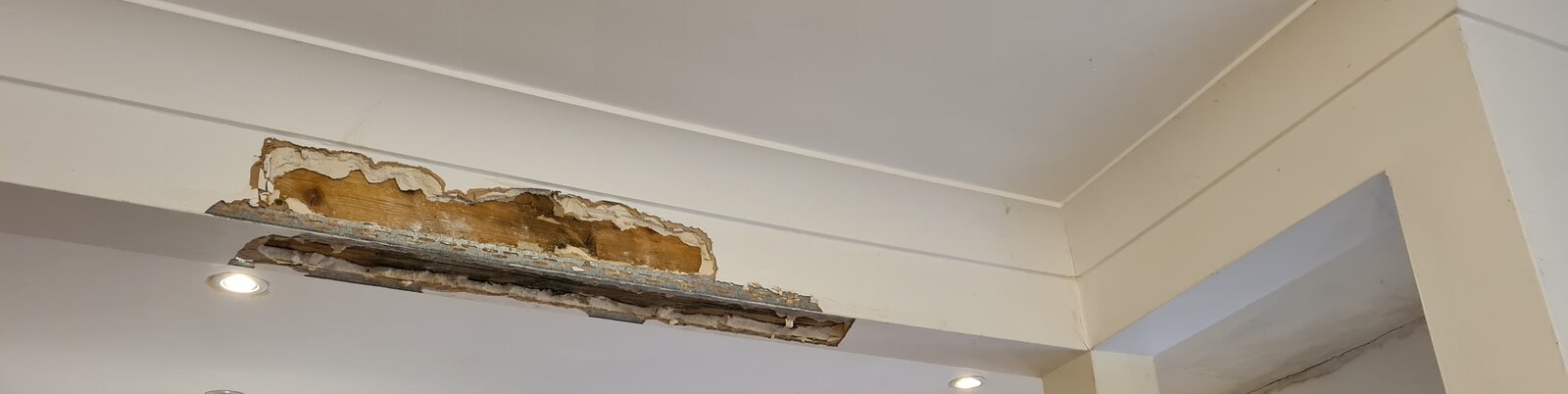

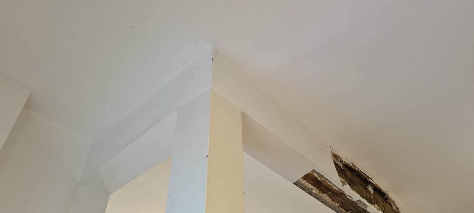

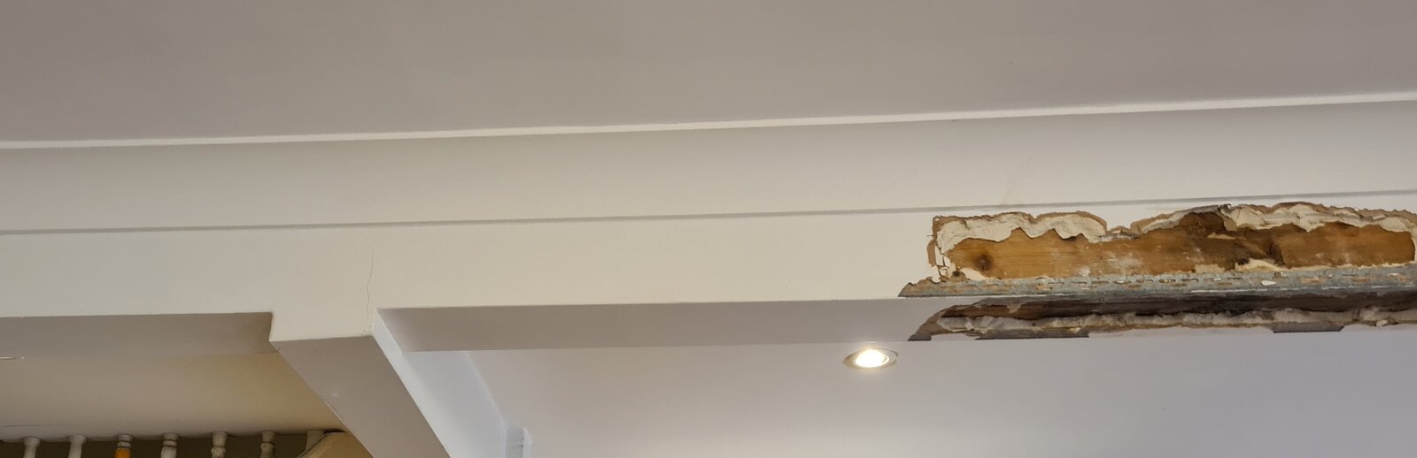

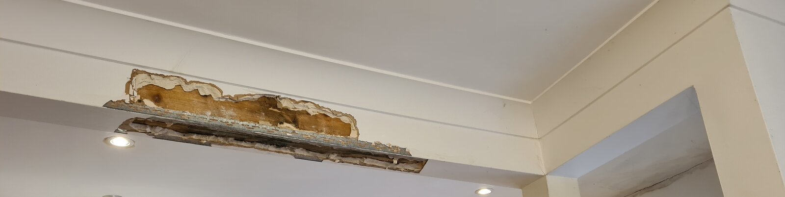

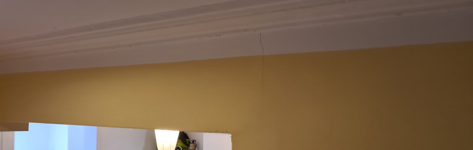

My brother renovated this house about 20 years ago and took out a wall he claims was definitely not load bearing. Recently we had a bit of leak in the bathroom which resulted in a big chunk of plaster falling apart in the kitchen below and some new hairline cracks appearing in the plaster around this beam.
The timber seems to be in decent condition but the plaster cracks suggest that there's been a bit of movement and it does feel a bit like the floor slopes a tiny bit above there.
Do I need to replace it or can I just get it boxed in again?
The beam looks like it's actually 2 joists stuck together. Total dimensions are about 18cm x 10cm x 300cm

Maybe the leak was long time leaking becaause the beam looks like its got advanced wet rot.
The beam might have to be replaced?

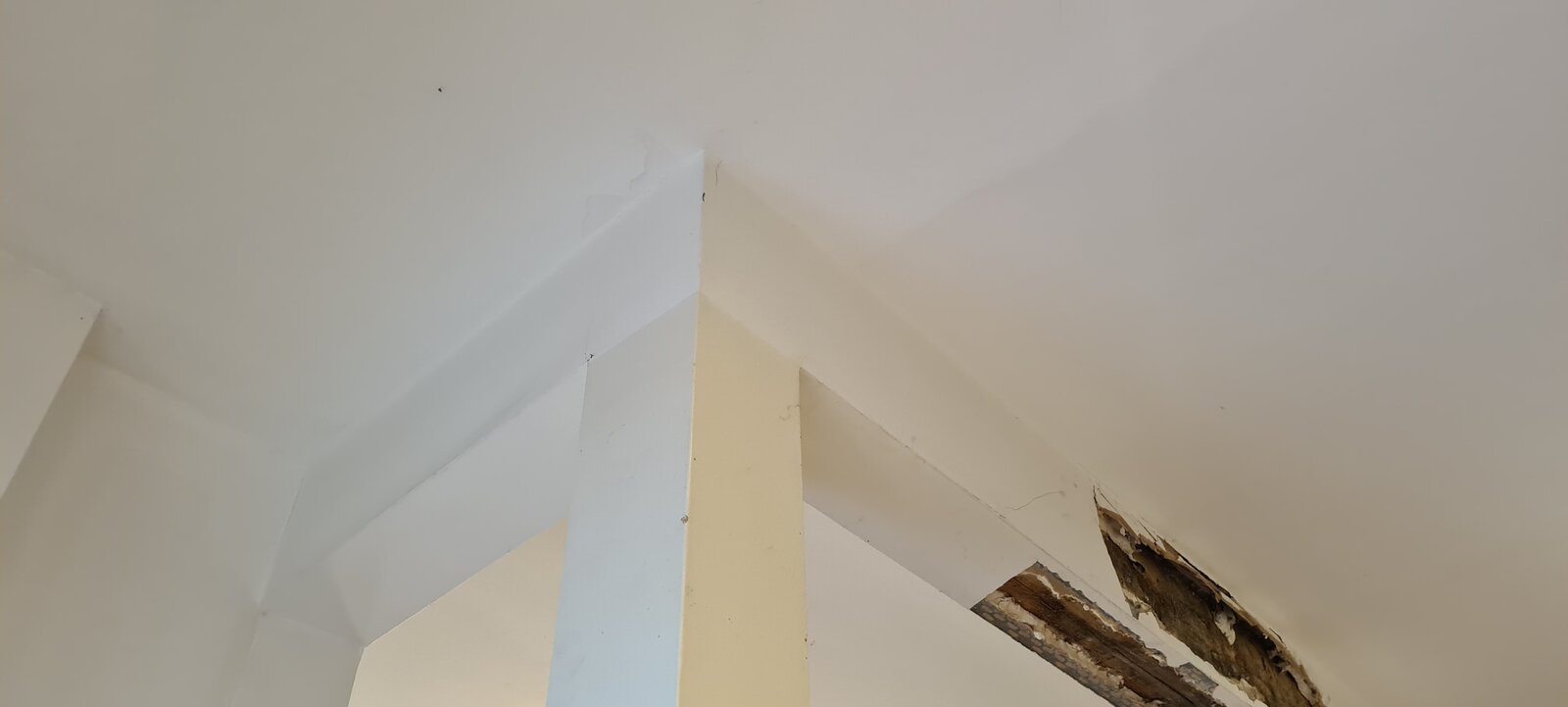

In the last pic its not clear to me whats supporting what - did you remove two or more walls during the renovation?

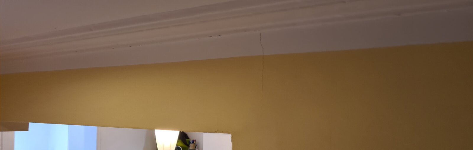

You show various cracks but when did the cracks first appear?
If the beam has to be replaced then some propping will be needed and then the p/board wll have to be removed from the beam so you can see how the beam has been fixed up there.
You will have to remove some p/board even if your only attempting repairs.

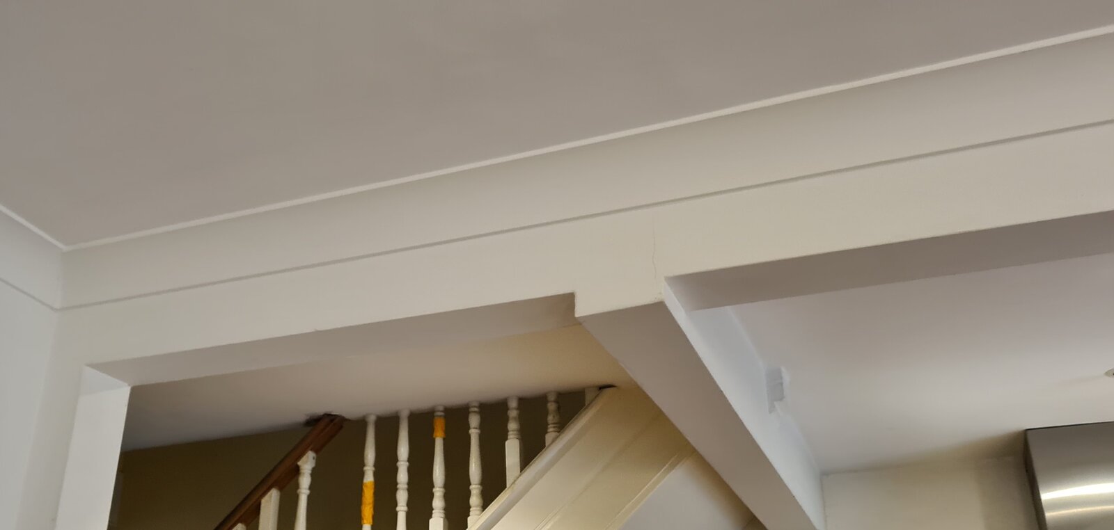

I'd suspect that the floor above - the bathroom - has dropped a little.
Why not get a straight edge and a level and check how level the various beams are and how level is the flooring above.
Look for any gaps under skirting or slight unlevelness in door trim heads.
There are some spots where I can get a butter knife in maybe 4-5mm which I guess means it's not survived totally unscathed. It might have been wet for quite a while. There is definitely some discoloration.
There's a post at one end of the long span that's stayed by a shorter span that anchors it to brick wall. I guess this it to help keep the post true.
Can't say for sure unfortunately.
why would he feel the need to install the timbers in the first place if the original wall was not load bearing?
If theres no load the state of the timbers is pretty irrelevant. assuming theres no sign of dry rot or woodworm reboard it and skim.
The whole house is a bit of a weird mash of DIY projects. He also made all the sash windows, kitchen cabinets and fitted wardrobes himself.
There would be a support structure under the floor if it was originally load bearing and I'm pretty sure there isn't one.
