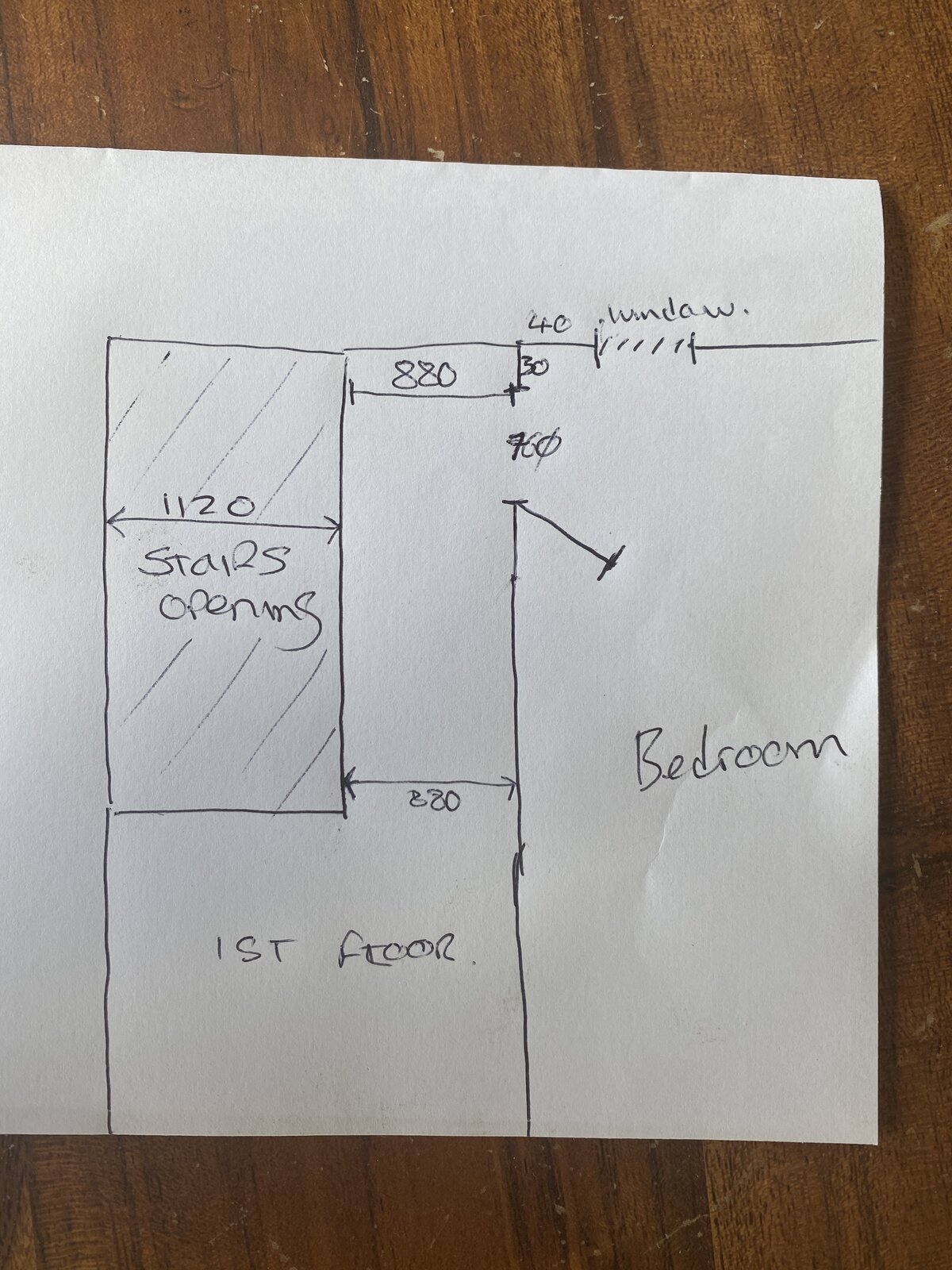

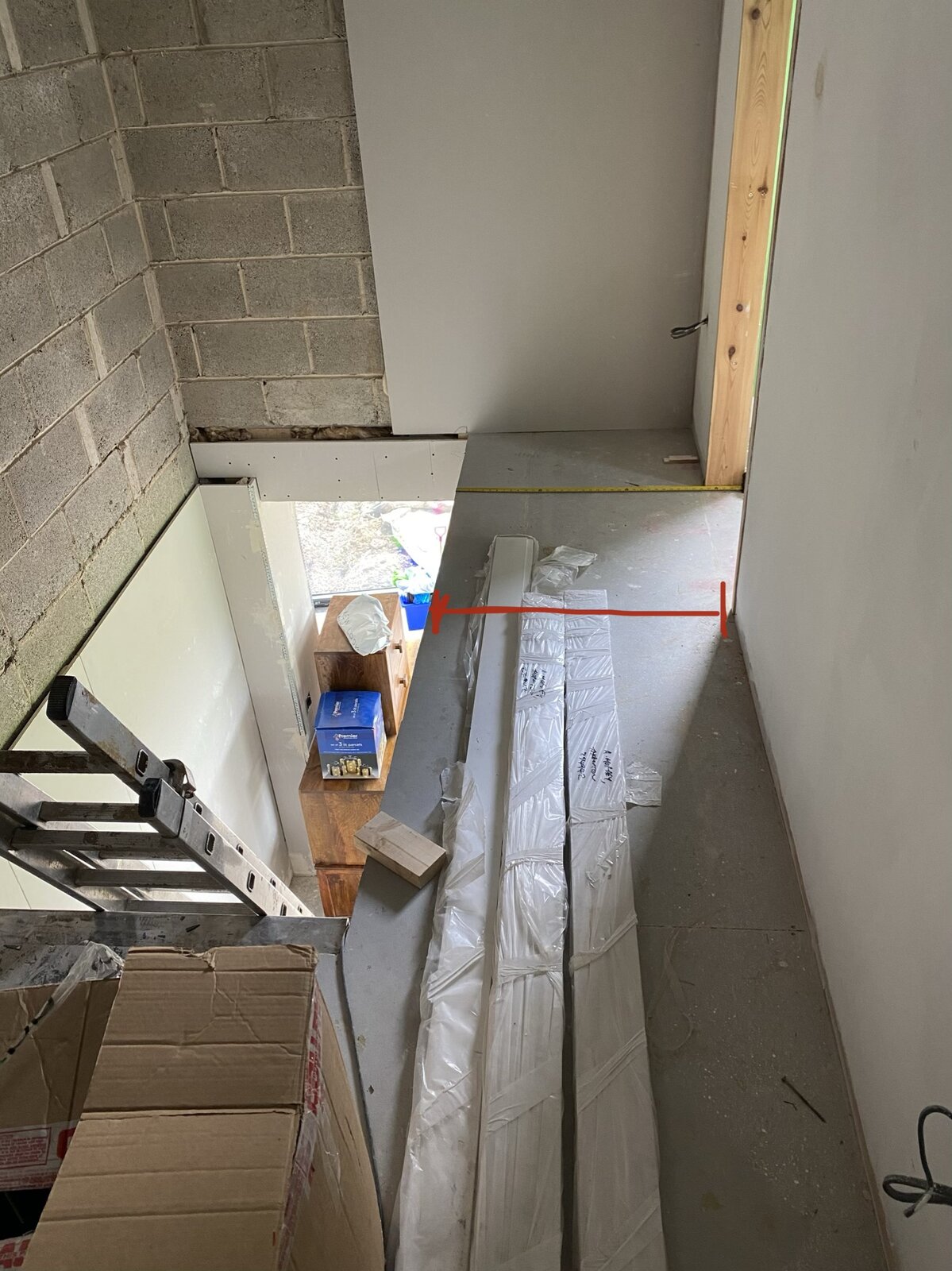

Hello. I’m in the midst of finishing off my self build but stumbled across an issue while talking to the staircase contractor.
the hallway that adjoins the landing to a bedroom isn’t wide enough I don’t think. It measures 880mm I’m not sure if it should be 900 or 1200.
1200 would cause me a real issue as I’d have to encroach into the stairwell opening a fair bit reducing the width of the steps.
I thought about moving the entire bedroom wall (most expensive) or perhaps just the door but would mean the hall is redundant.
I could make the door frame wider to allow for a the 900 hall way and bolt on a additional joist below the floor with a ‘strip’ of chipboard on the top.
I presume a oversight from the builder while making stud walls has caused this.
Would someone be able to clarify what the hallway width should be? Help with, or suggesting a solution would also be appreciated.
I’ll try include a pic/sketch. At present the forum won’t allow me to upload off my phone.
thanks in advance

Hi. Sorry. The problem is that I don’t think it meets with the regs. So wouldn’t pass building control/inspector sigh off
Only from my own research online which I know is not gospel so thought I’d ask the experts here.
the resource I found is here
http://www.lifetimehomes.org.uk/pages/6-internal-doorways-and-hallways.html
which states
Doorway widths within dwellings
Head on approach to door within dwelling
The minimum clear opening width of any doorway within a dwelling, when the approach to the door is ‘head on’, is 750mm.
Turning to pass through a door within dwelling
When the approach to a doorway is not head on, and a turn is required to pass through the doorway, the minimum clear opening for that doorway will relate to the width of the approach (typically a hallway or landing), and should be in accordance with the table below:”
Table on the link above. Table says I need a 1200 wide hallway to pass through a standard 750 wide door.
I notice your document uses the word "should" and not the word "must."
This is usually a clue that tells you it is talking about advice or best practice rather than regulation.
But I don't know the answer.
Thanks. Yes, most of the documents say should. My assumption is that this is documented for a reason as such that it must be observed in new builds and compromises made in such a case of an old building. However I want to make sure I’m doing it right do avoid costly changes down the road.
Do you have a Planning condition or any other condition that requires you to meet the Lifetime Homes standards?
Not that I’m aware of. It’s not something I’ve heard mentioned or recall. I’ve just used that site as a reference assuming it was a standard reg
2ft 6" door plus 2x 70mm arcatraves set back say 9mm [160mm] so 765+160+4mm so 930mm give or take 100mm now if you have a right angle best to plus 100mm to allow clearance for furniture but not a requirement so 880 tight 1000mm better
To confirm. It’s not a requirement but best practice to be wider than currently is ?
