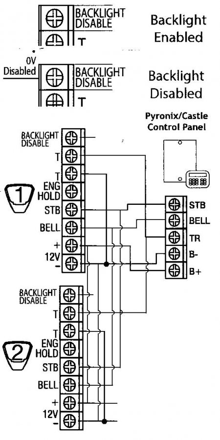

Hi I wondered if anyone could help me understand how to wire up two bells...
So far I wired it up as follows.
so far it seems to work, but wondered about the tamper, if one bell was tampered with would the other bell tamper work?
I've uploaded a wiring diragram..
the second thing I would like to know is,
I want to turn the back light off, which is apparently achieved by 0V into the Backlight terminal.. but I don't know how to achieve this...
any help massively appreaciated...
Thank you
James..

Ignore the two devices on the right (that was for two internal sounders)
the terminal marked - will most likely be your 0v so a bridge between the - and disable backlight should work.
thank you very much Uncle Bob...
