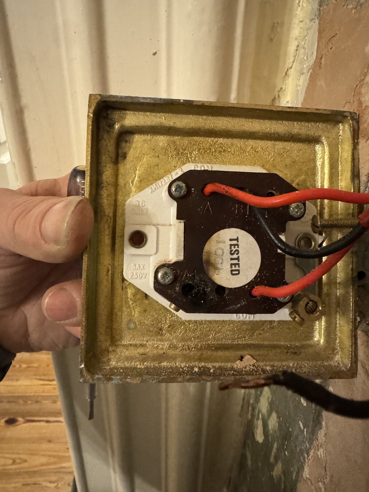

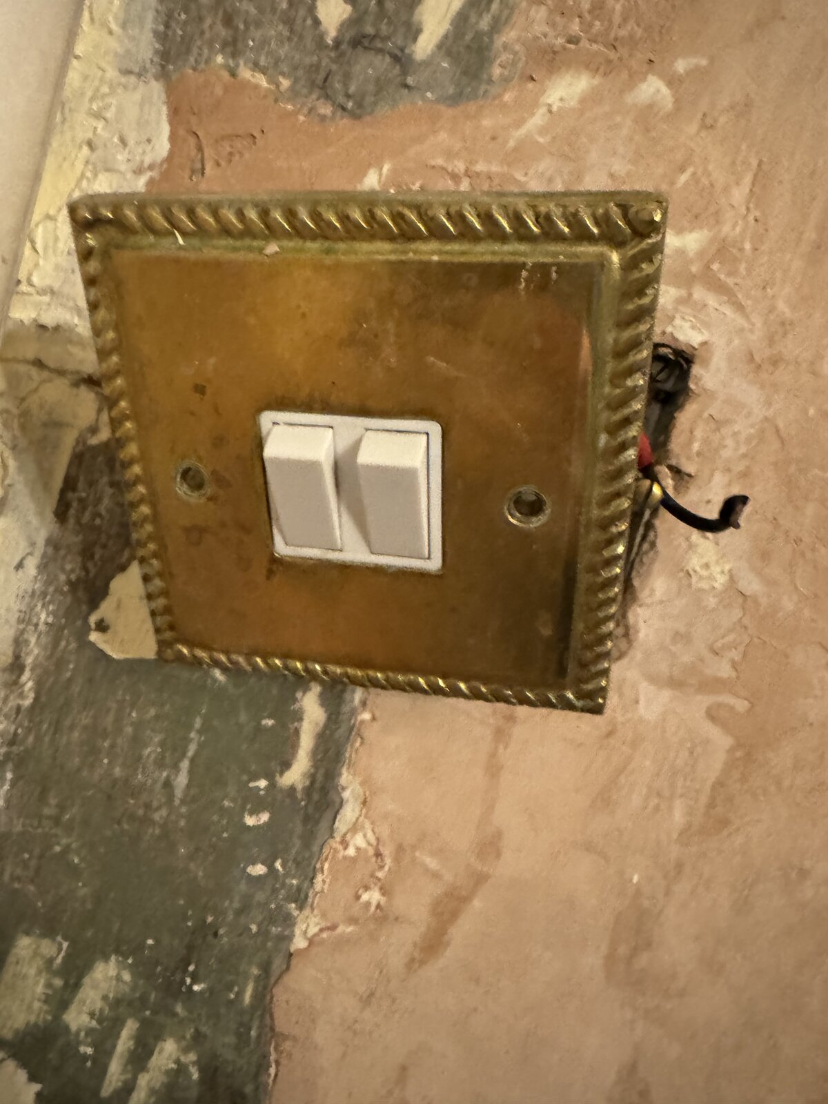

2 Gang 1 Way Light switch arcing and burning
Lights are conventional filament at the moment but will change to LED later.
Stripping with steam so yes suspect
Will add pigtail from wall box to switch once I find a shop open today that has them in stock.

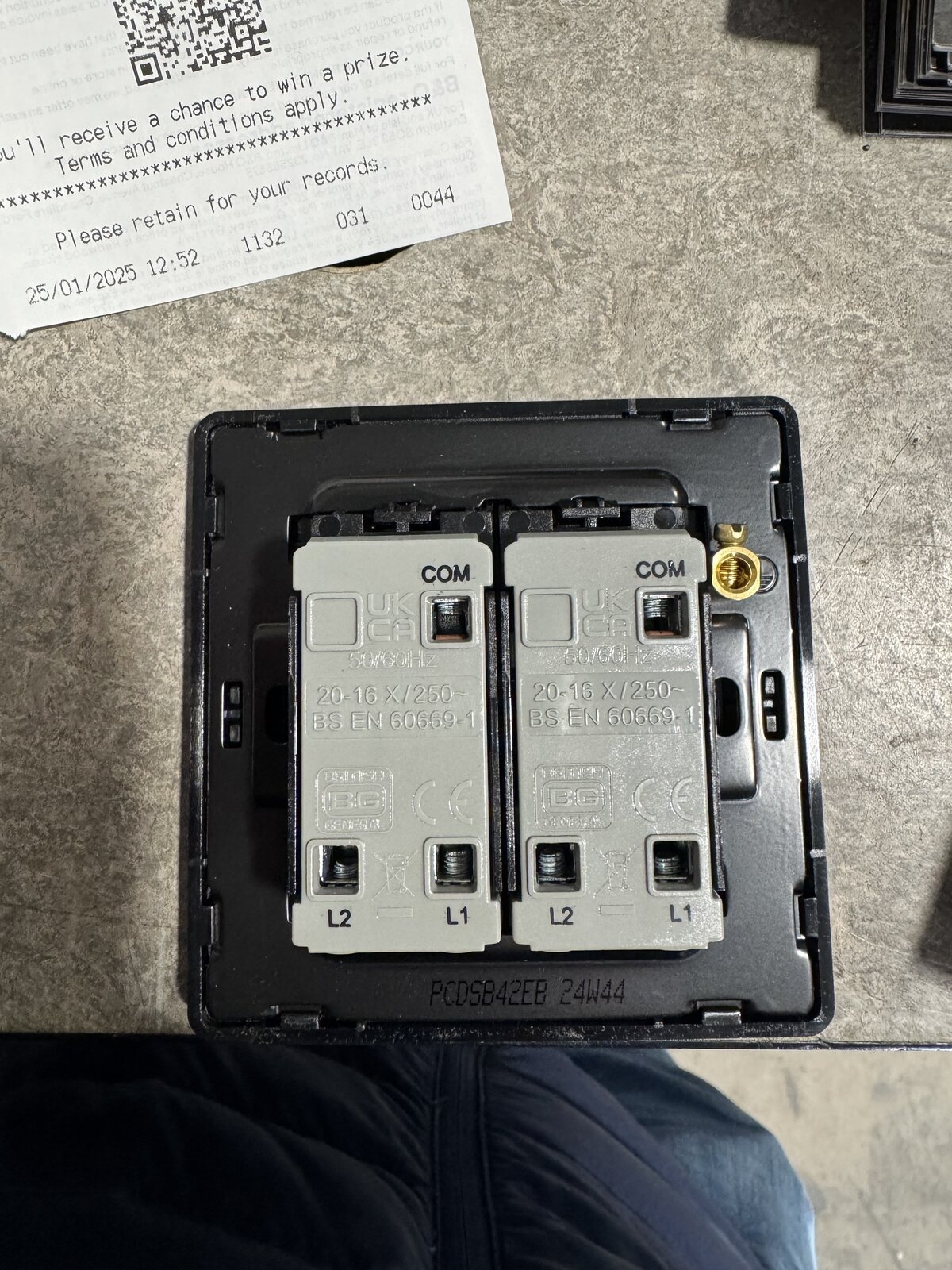

Ok found a switch if someone could help me understand how to wire it I’d be grateful.
One circuit for ceiling light one circuit for wall lights.
I suppose I’ve got to find the corresponding pairs red and black with red sleeve.
Com and L1 on each switch. L2 is not used. Earth must be connected to the brass terminal on the side.
All good worked perfectly, thank you very much although I wasn’t able to get the same kind of light switch I used the plastic white two gang to way until I can get the right style
