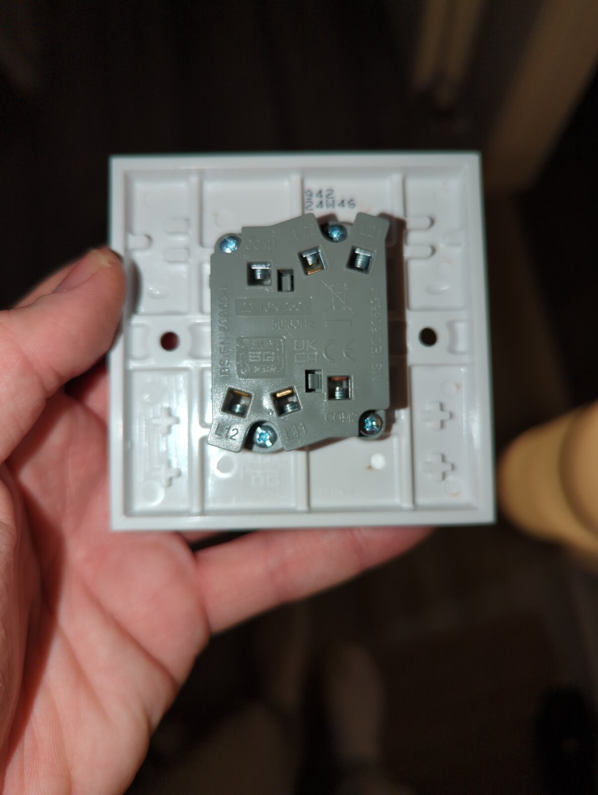

2 gang 1 way
If I were to change the switch to this one would L1 be L11 or L12?

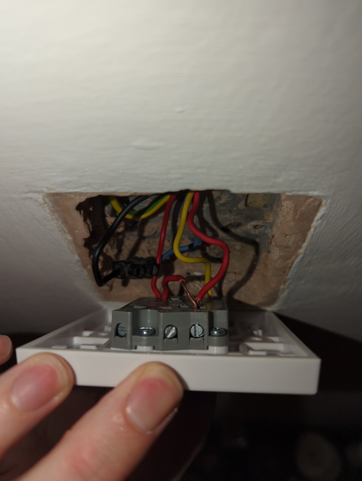

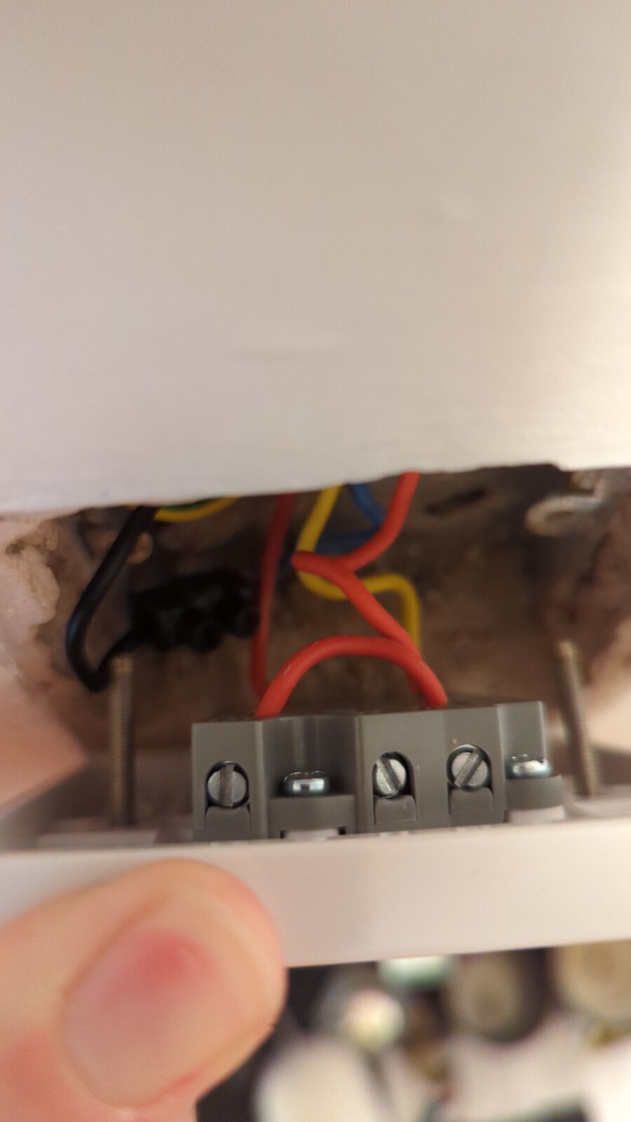

If that blue definitely goes to a neutral in the light then do as I said in #4
So like this?
It works!! But the switches do the opposite but they work so couldn't care less haha, thank you so much!!!!
You need to tidy that up you shouldn't see any bare copper.
Does the light have it's own pir? As that would be on permanently
it does, its a motion senser light that only comes on when it sense people, i shall get a sleeve for it and leave it off until it arrives, thank you :)
Or a longer piece of wire but dont strip as much off.
It wouldn't do you put both reds in com, move one to L11 or do you mean via the pir
so should i take out the joining wire that links both coms up aswell? or still do it from L11 to coms?
