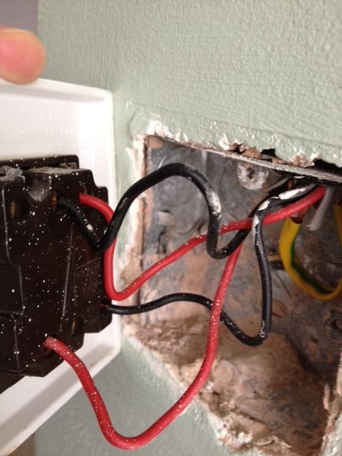

How many cables/wires/cores to the switches? You have probably wired one of the switches so you have bypassed the contacts. A photo of the back of the switch with cables attached would help.
And your diagram is wrong, at a switch the only terminations would be live and switched live, no neutrals.
As mentioned a photo would help.

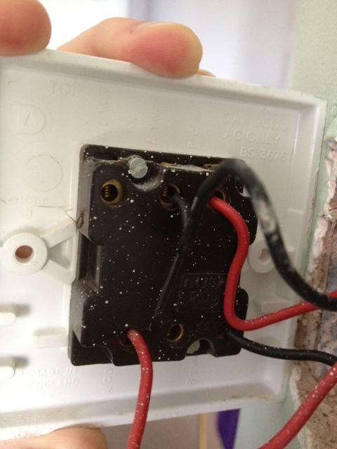

These are pics of the old switch... i was assuming live and neutral because of the colours... this may not be the case.
The labels across the top are:
A 2way / A 1Way / B Com
The ones across the bottom are:
A Com / B 2Way / B 1Way

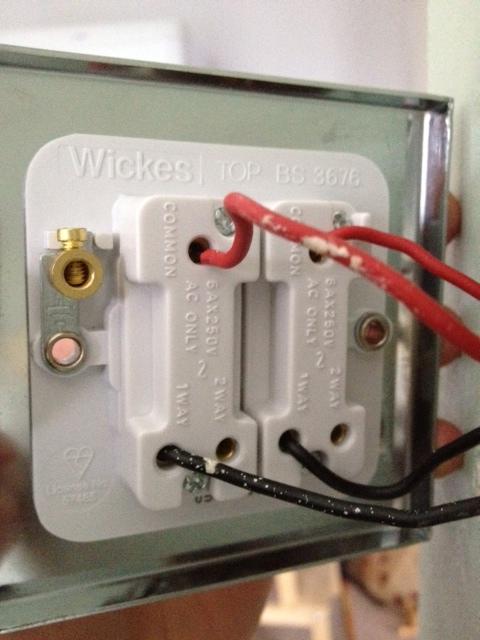

This is the new one:
You don't have neutrals connected to the terminals you have switch live.
So change the neutral for switch live below.
You have put the Live 2 and switch live 1 and vice versa on the same switch which is wrong.
Should be:
ACom X = Live 2 (red)
A1wayX = Switch live 2 (black)
BComX = Live 1 (red)
B1wayX = Switch live 1 (black)

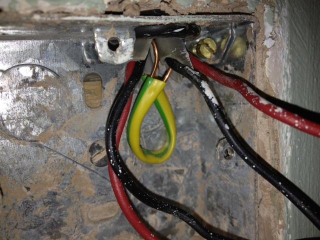

Separate out the two T&E cables:
Put one red in com and the black from the same cable in 1way on the same gang.
Do the same for the other one.

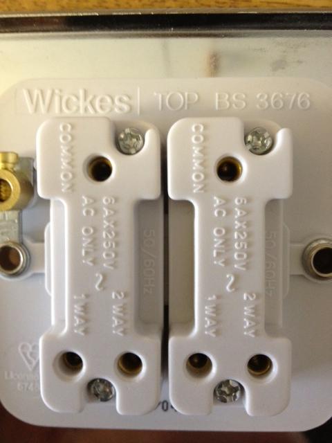

FHS - each one has terminals labeled Com(mon), 1-way and 2-way.
On the old one because there's one lump of plastic they tell you which belong to switch A and switch B.
On the new one you have two physically separate switches.

One of the switches must be faulty. Does it feel and sound the same as the other?
Apart from both wires in the same terminal, there is nothing you can do wrongly which would result in the light being on permanently.
I've followed those instructions but still no joy (the switch on the left as you look at the switches or the right as you look at the wires from the back) remains permanently on.
See below pics.
I appreciate the help - but as suggested by BAS above - I might call it a day if the solution is not really obvious, as this is pretty much the extent of my abilities fully tested now.

One feels less "Snappy" than the other but I was quicker to assume a mistake on my part rather than a faulty switch. It's definitely a possibility though... given that I have been wiring the switch the same way each time.
If you have put the same cables red and black conductors in their correct gang then as EFL stated you may have a faulty switch.
New switches sometimes are 'sticky' turn the power of and flick the problem switch on a off a number of times this may free the possible contact problem.
Failing that take it back and get another one.
