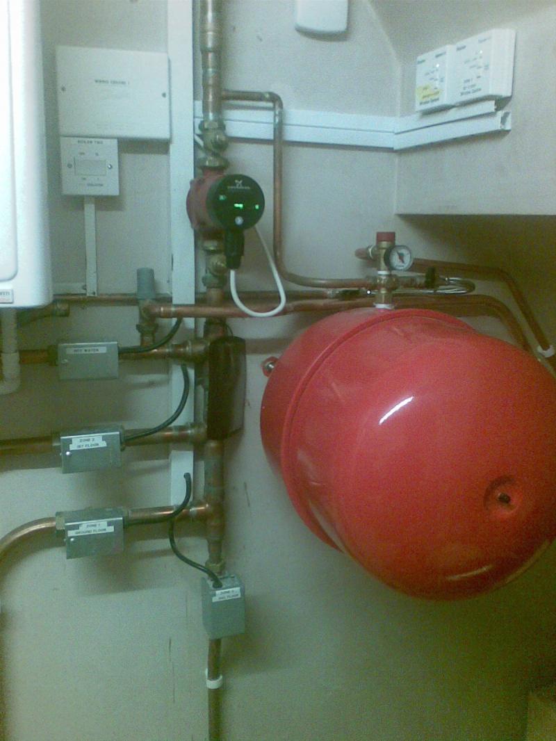

id be looking to fit a pump on each boiler return,as the drawing is based on a system boiler with internal pump,or 1 large shunt pump serving both boilers.
as for photos,if youve uploaded them into your album,then use the show my images option to insert them.
if your struggling email them to me and i'll pop them up for you(emails in my profile)

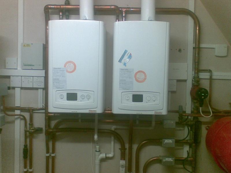

Hi Lcgs thanks for your help, i have now loaded the pictures that people have been asking for , what are your thoughts on the low loss header. If we fit 1 we may make it ourselves but we would need to know the dimensions i have downloaded the diagram off the Kelston site but i dont know if this is ok for our system we have also got to fit check valves that Argile sugested we do.

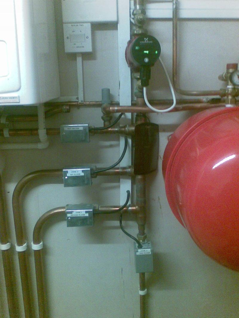

Personally I'd always fit a llh to multiple vaillants,you might as well buy vaillants own header it's about £140 and saves the messing of having to make one.
Trouble is to get it in you'll be repiping a lot of what you've done.the 4zones you have if your fitting a header,you can wither install one system pump to do them all and leave the 2ports in plus bypass or replace the two ports with individual circuit pumps.
What ever you do it's now hard work.
Simplest solution could be to fit bigger pump allowing for the high kpa of the boilers and the system.
Its a personal thing but I don't like to see 35mm pipe feeding a 15mm ported pump(your alpha),oh and just as a by note those boilers don't like modulating pumps.

Thanks we were intending replacing the alpha with a light comercial that we have allready. and we were thinking of using the alpha as a shunt pump.
The quality of the installation is generally not bad which surprised me because of the three main so basic problems which I see with its operation.
They are:-
1. Pump grossly undersized for boiler power.
2. A boiler sequencer fitted with no provision to stop back flow through non-op boiler.
3. No way to isolate either boiler for maintenance or testing.

Lee seems to be considering this a a new requirement which you are now going to install to meet the requirements.
The reality is that you have an existing installation which you will want to get working with the minimum to be done.
Check valves are only required when you have one pump per boiler. You dont have that!
To enable the sequencer to work properly, you need to add some way to stop any flow through the "off" boiler. While that would usually be achieved by one pump per boiler with check valves, in your case it would have to be with a motorised valve. That will have to be installed so that an over run delay can be provided to enable the boiler to cool down.
The better solution will probably be to add a pump so that each boiler has its own pump. That will also enable the flow/return differential to be more accurately retained when only one boiler is in use.
Isolation valves enable maintenance/replacement to be done while the second boiler continues the service. It seems very odd to fit a boiler without them.

As I said it would be better to fit one pump per boiler with a non return valve on the return. Then the sequencer will be able to properly control the boilers so that just one can work without the pump still sending half of the flow through the off boiler.
Fitting a spring return motor valve to the return connection to each boiler would achieve the same result but enable a single pump to be used. But we think your pump is undersized already so thats not a recommended option. Furthermore the valve would need to be connected so that it remains open for the pump over run period.
