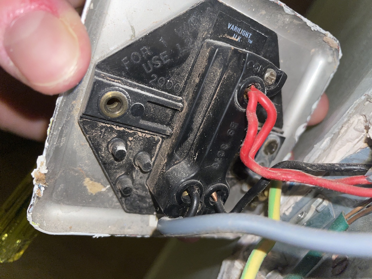

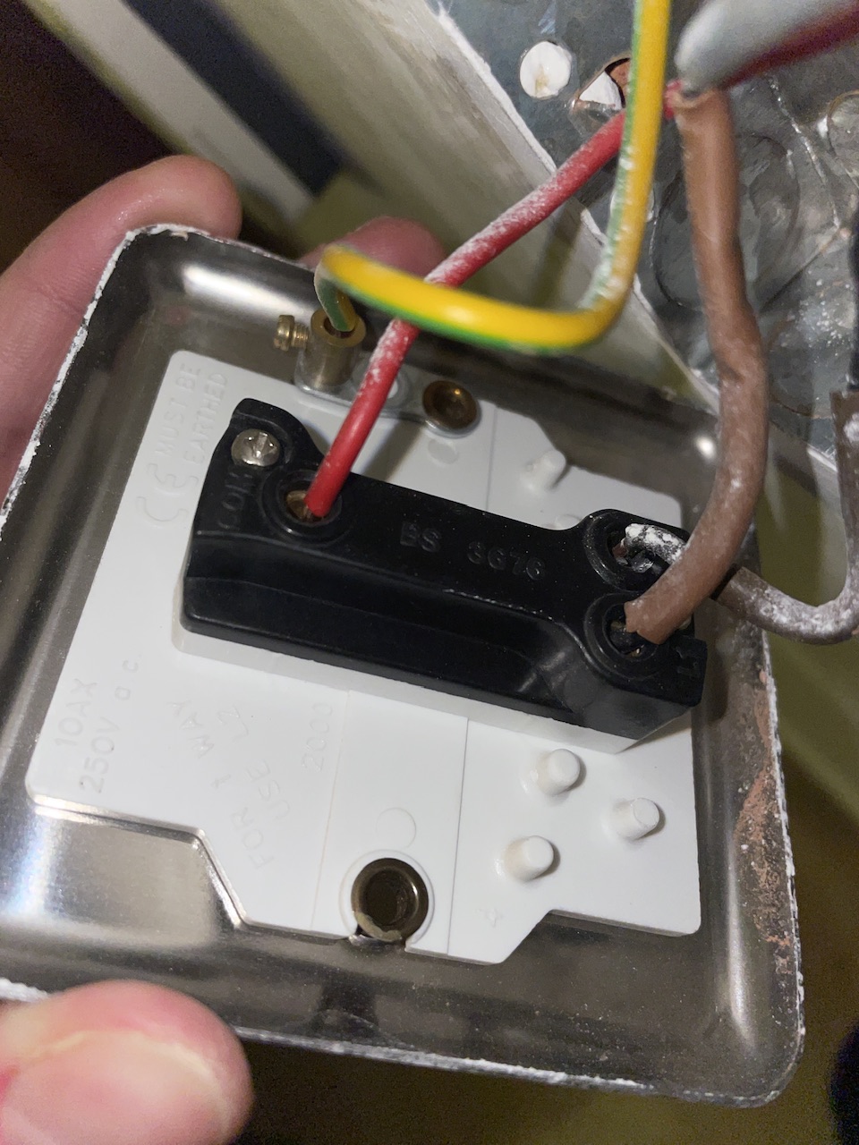

Moved into a new house and we have 2 switches in the dining room (one near each door at opposite ends of the room).
They don’t operate as id expect with 2 way switching where both switches can turn the light on and off.
One of the switches seems to act as a ‘master switch’ and has to be left in the on position for the other switch to work. If it’s turned off then the light can’t be switched back on with the other switch.
Have the switches been wired incorrectly or is this just how they should operate?

Not counting earths I would expect 5 wires on master switch and 3 wires on slave, I can only see 4 on the master switch.
Also would only expect one wire in com on both switches, but I see two on the master.
However there are many ways to wire two way switches, in the main it needs three wires between the two switches, but I have seen a pair of dimming two way where only 2 between master and slave.

Yes, I agree. Two reds in the COM doesn’t look right.
Needs some detective work, unlikely to be fixed via an Internet forum, IMO.

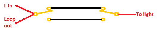

From what I see it is potentionally wired conventional 2 way:
Which should be quite straightforward to faultfind
View attachment 329203Which should be quite straightforward to faultfind
However before offering any advice I'd like to know if there are any other wires at the switches and is there any test equipment available?
No other wires at the boxes other than what’s already connected to the switches in the photos.
A multimeter and an electric screwdriver…
I suspect in the second picture swapping red and the top right sleeved wire might fix it.
If its what Sunray said which is plausible, then in the second picture the red and the bottom right sleeved wire would be the travellers.
The way it is wired now, the master switch (assuming the left photo?) would liven up one of the travellers. The only way to make the light go on is for the red traveller to be live, and then the second switch to connect that red wire to the top right sleeved wire.
If you only have a multimeter, switch everything off and then confirm that the L1/L2 on the first switch are connected to the red and bottom right wire on the second photo. Simply disconnect the wires both ends, confirm with a resistance check from one end that there's no connection, then short the other end with a wago/terminal block/whatever, and then that the resistance is low. If that holds, try the experiment I said.

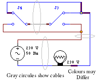

There still needs to be in the main three core and earth, I know
is the more normal way as no block connector required in the lamp, but if switch back box used as the junction box instead of the ceiling rose, then there would also be neutrals in the back box.
I do agree however some test equipment is required to fault find.

View attachment 329261There still needs to be in the main three core and earth, I know View attachment 329262 is the more normal way as no block connector required in the lamp, but if switch back box used as the junction box instead of the ceiling rose, then there would also be neutrals in the back box.

In the left picture I think I see a varilite dimmer, 2* T&E but only one black from them and a single sheathed black, at the right switch I think I see one red and 2 blacks sleeved brown. I'd like confirmation and more detail of those ideally by pictures showing the cable sheathes or a good description of them at both switches. before I can answer further.
Thinking further I'm wondering if it's all wired in single&E sheathed cables
Oh silly me, this appears to be a dimmer, does the dimmer work?
