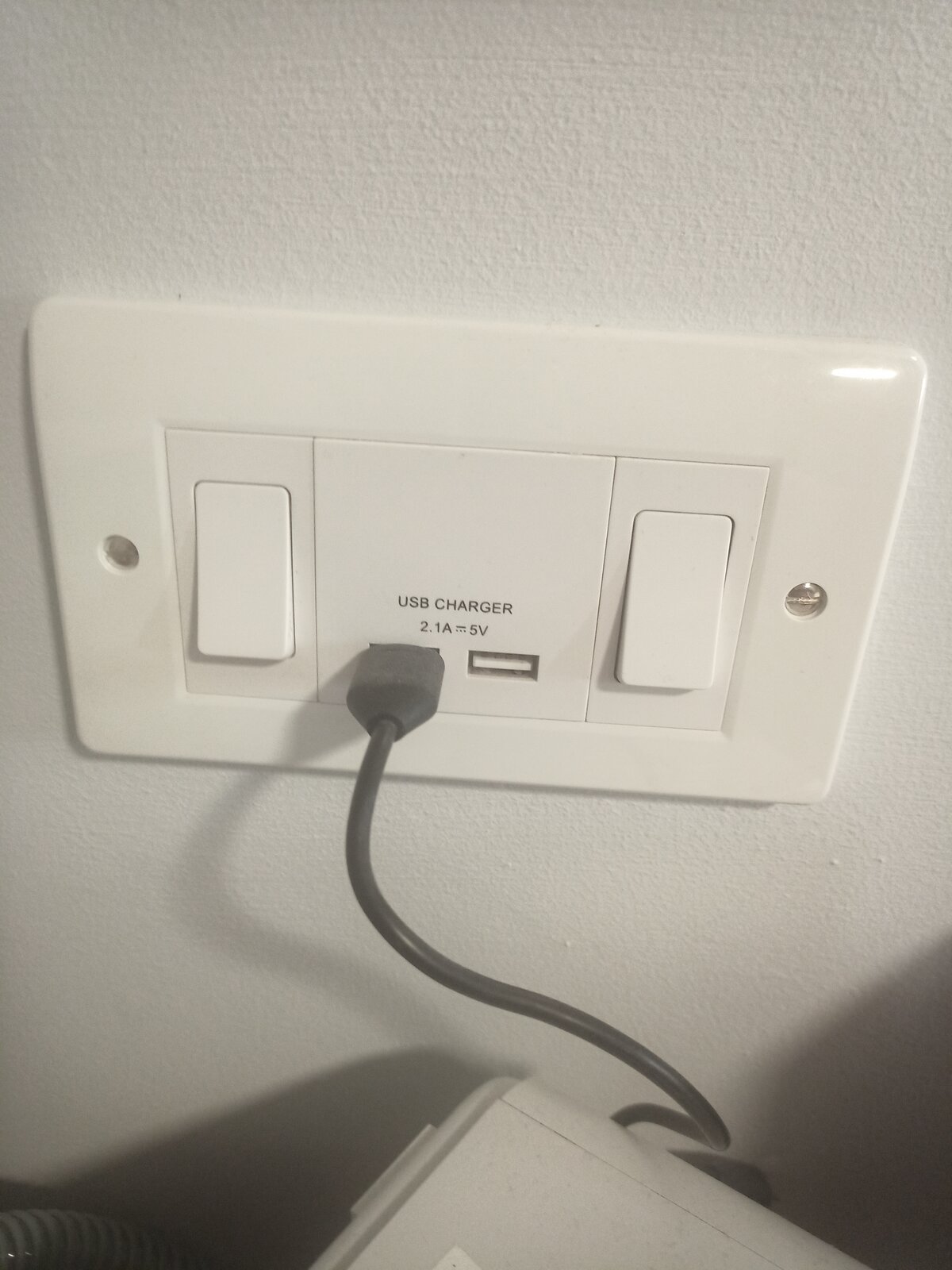

I found I could not get a 3 gang intermediate switch, so used a 3 gang two way switch at door and two 2 gang intermediate switches one side of bed, and 2 gang two way other side of bed, so bed head lights worked at door and side fitted, and centre main light any of the three switches, the bed had to be positioned to suit switches and lamps as there was a flue brick and the lights and switches had to go either side.

We have exactly the same and it works really well. The only thing I'd do differently is we hardly use the main light and certainly not from bed, so i wouldn't bother with that another time. Maybe a floor level night light instead on the second switch.
That's what I have:
3 x 13A sockets slightly above the skirt around the room switched from 3 positions; the doorway and either side of the bed.
Here is one of our bedside switches, incorporating a USB charger for phones etc ..
